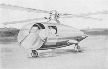

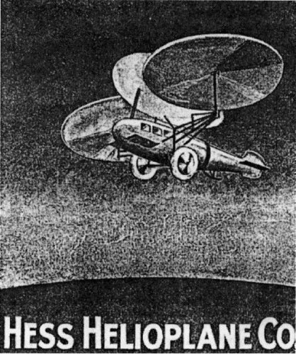

There were two Canadian helicopter designs before Duben's. First was the 1935 Helioplane by John Hess Helioplane Company Ltd. of New westminster, BC (based on 1928 patents). See CAHS Journal article by Robert S. Petite: http://www.helicopterheritagecanada.com/hess1.pdf

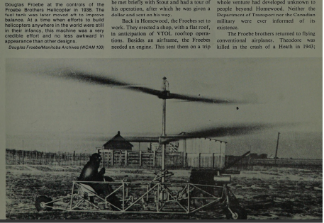

The second was the Froebe co-axial helicopter, a homebuilt from Homewood, Manitoba. The Froebe brothers' 1938 Gipsy-powered machine is better know since it survives at WCAM. The Hess Helioplane prototype was scrapped in Vancouver sometime in the early 1950s. Not sure what the fate of the 1945 Duben helicopter was.
Thank you my dear Apophenia very much,
and I can't prevent my self from displaying those two drawings to Hess
Helioplane in your PDF site.

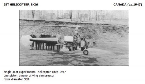

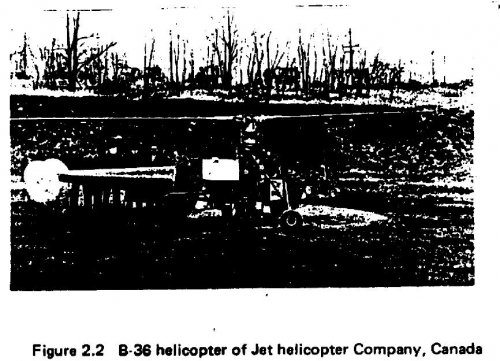

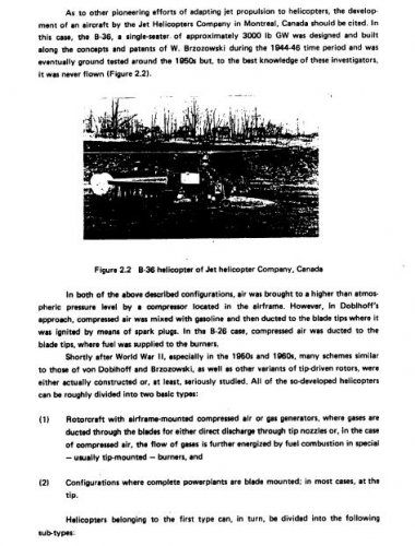

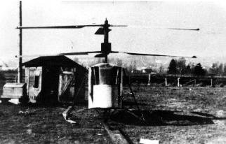

The B-36 experimental helicopter was project by several Polish engineers in Canada. Possibly work already started in Poland. A company named Jet Helicopters Corporation (Jet Helicopters Limited?) was founded in Montreal circa 1947. The heli used the cold-jet-principle with a piston engine driving a compressor which ejected from nozzles at the rotor tips.
Design team included Messrs. Witold Brzowski, Wieslaw Stepniwsli, Tadeusz Tarcynski
I have a bad quality picture, which shows the B-36 under (tethered) tests around 1948-1950?.
Anyone with technical details (what engine etc.) of the B-36?
Walter, no details but a few corrections that may help with searching.
'Witold Brzowski' should be Witold Brzozowski and 'Tadeusz Tarcynski' should be Tadeusz Tarczynski. The late Prof Wieslaw Z. Stepniewski was, of course, quite well known (and had come to Jet Helicopters from De Havilland Canada where he had been Head of Aerodynamics and Stress under Jakimiuk).
Witold Brzozowski had been involved with the development of the North Star at Canadair (dating back to its days as Canadian Vickers but quit in 1946 (not 1947) to start Jet Helicopters Corporation. The company was formed in Quebec but moved to the US to build a prototype. With no financial backing, the firm folded in 1947.
AFAIK, after the failure of Jet Helicopters, Witold Brzozowski returned to Quebec (his address on his 1952 US patent is given as Westmount, Montreal). Like a lot of Polish engineers in exile, Stepniwsli and Tarczynski, ended up at Piasecki Helicopter. Both stayed on in Philedelphia until Piasecki became Vertol (Stepniewski later taught at Princeton).
BTW, Tarczynski and Stepniewski first worked together in Poland on the TS-1/34 Promyk sailplane. Tarczynski worked on the PZL Wilk and Lampart projects before leaving Poland. He became a test pilot at DHC during WWII.
Hmm... a picture even of a bad quality is better than no picture, don't you think? It would be interesting to see it.

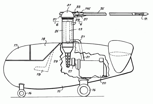

HELICOPTER WITH JET-OPERATED ROTOR
Witold Brzozowski, Westmount, Montreal, Canada
assignor to Stefan Czarnecki, Walden, N. Y.

Attached is the picture I have (Word format, but saw this worked in the past).
  • JET HELICOPTERS B-36.doc
A screen snip of walter's B-36 helicopter photo.

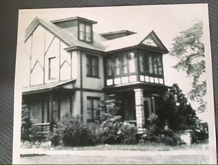

Hi Stargazer 2006,
I am a local historian writing about people who have lived in my région. Witold and wife Antonine Des Rochers lived in Montebello from 1951-1960, on a large piece of land purchased from Leo Chenier. This is possibly a historical site. Plz help on finding more info. Witold’s mother lived with them for a while and was called Mamushka. Any children? Did he take Michel Gaucher with him to Turkey? He was rector of which university In Turkey? How is he related to you? À brother-in-law, Dr Des Rochers was a doctor in Montreal, are you related to him or Michel Bédard? Remember the house now gone? Simple historian curiosity.. The land was sold in 1960 to Harry Smith. The family was well liked by all neighbours who have fond memories of the couple.

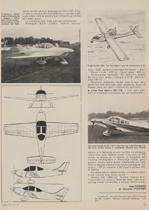

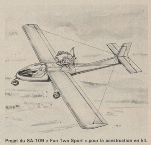

From Aviation magazine 1979 & JAW 1988,
here is the MacFam Cavalier (McASCO) aircraft,included SA 102,103,104,
105 & 106,with Jungster I & II,also the SA 109 Project.

The following may perhaps be of interest.
By 1971 at the latest, K&S Aircraft Supply of Calgary, Alberta, acquired the rights to produce two American-designed single-seat aircraft, the Kaminskas RK-1 Jungster I biplane and RK-2 Jungster II monoplane. The Jungster I drew its inspiration from a well-known and respected German two-seater aerobatic aircraft which first flew in April 1934, the Bücker Bü 131 Jungmann. K & S Aircraft Supply subsequently sold several sets of plans.
The firm also drew plans for the four-seater SA 102 Cavalier, a deeply modified derivative of a homebuilt single-seater of French origin, the Gardan / Orm-Hume GY-20 Minicab. K & S Aircraft Supply soon sold several sets of plans.
Renamed Macfam World Traders towards the end of the 1970s, the small company offered its customers derivatives of the Cavalier, as well as the SA-105 Super Cavalier and the SA-109. The company's McAsco Aircraft division, a corporate name adopted circa 1984, developed a two-seater, the SA-106 Lady Bug, which may not have flown. The McAsco Aircraft division moved to the United States around 1988 but was no longer talked about after 1993-94.
Victim of the ongoing economic dislocation of the early 1990s most likely, courtesy of the collapse of the Soviet Union and the end of the Cold War among other things.
