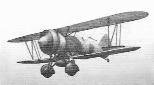

theponja said:
I can't read Polish ... less Japanese :(
I can read Polish.
They write this is Nakajima 6-Shi experimental dive bomber (the first aircraft of such type in Japan) on the photo. But the text is about its successor - Nakajima "7-Shi special bomber" aka N-35 Tokubaku. The specification for 7-Shi dive bomber was issued in 1932 when it became clear that 6-Shi aircraft isn't very successful. The only N-35 prototype was built in late 1933: as well as 6-Shi, it was created by eng. Junichiro Nagahata representing Kaigun Koku Hombu's Department of Development and Nakajima's engineer Ryozo Yamamoto. The aircraft was 2-seat biplane with foldable wings and fixed landing gear. It was powered by Nakajima Kotobuki 2 Kai 1 9-cylinder radial engine (580 hp takeoff power, 460 hp at 3000 m altitude) and could carry one 250-kg bomb. The flight tests results weren't satisfactory (the aircraft kept all the disadvantages of its precursor), so Kaigun Koku Hombu decided to cancel the program.
LAW, redstar72 thanks a lot for clarify the subject. Now is clear to me we have 2 planes with similar name: Nakajima 7-Shi Dive bomber and the Nakajima 7-Shi Carrier Fighter.
Anyone has more information, maybe a 3d view of Nakajima 6/7/8-Shi Dive bomber?
Many thanks for SPF members.
The level of this forum is very high!!!
Unfortunately I can't find any pictures or drawings of this aircraft because this aircraft was a perfect failure one, I think Nakajima Aircraft wanted to delete all of the record of this aircraft.
When dive test, the pilot failed to pull up, the aircraft penetrated into the earth almost 2m and the pilot died.
No2 aircraft did not allow to do flight test.
