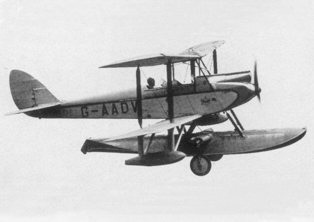

Here one example I have been able to find, DH.60G Gipsy Moth G-AADV on a Short Bros amphibious central float and wingtip floats.
Does anyone know of any more examples of relatively light, single-float amphibians or seaplanes that might help inform this concept? Any particular pros and cons come to mind with this configuration?

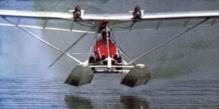

I'd go with a twin engined design (of some sort):
One of the appeals of float planes is that you can conduct emergency landings on bodies of water (eg. in case of changes to weather). In Canada we have hundreds of thousands of lakes - but you don't want to suffer an engine failure and end up somewhere in the trees between them.

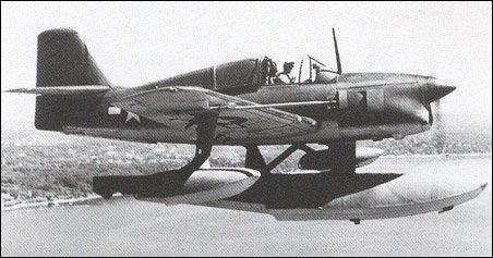

Here's the attractive Edo XOSE-1 of 1946. It was going to be the USN's next catapult-launched scout plane but for the end of the war and the advent of the helicopter.

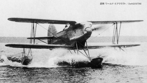

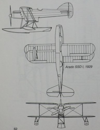

Thanks, the way the bottom wing is actually below the fuselage with the space between used for the radiator is an interesting design feature. Honestly, though, I am really looking for examples much lighter than these, say under 1000 kg gross weight.
