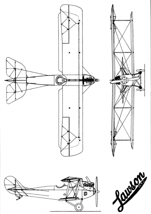

and of course I know this site,but has anyone a drawing for it ?.

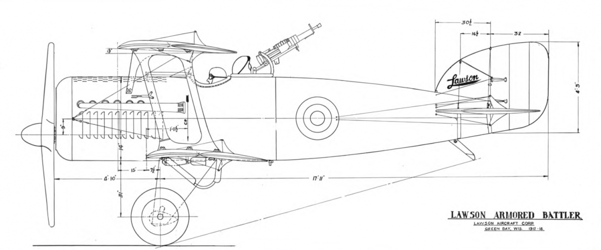

Does anyone know if this Lawson pursuit is the same design as the unbuilt 1918 Lawson Armored Battler?
I am curious to know if the Lawson Armored Battler's "steel fuselage" consisted of a steel 'box' (akin to the Sopwith TF.2 Salamander) or was it to have armour plates attached to conventional framing?
BTW: That "series of floating landing fields across the Atlantic" were to be converted 'flat top' merchant ships ... allowing Alfred Lawson to later claim to have invented the aircraft carrier (along with coining the term 'airliner') :)
My dear Apophenia,
I think it was anther design,but I will wait the experts ?.
Thanks Hesham. I suspect that you're right ... especially if Aero Files was correct about that "180hp Hisso". The power output suggests a Wright-Hisso E-3 (or French-built Hispano-Suiza 8Ab/HS-34) ... an upright V-8 engine.

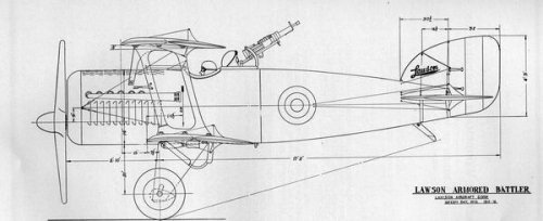

Going by the sideview drawing, the Lawson Armored Battler was powered by a V-12 (presumably a Liberty). This aircraft was to be a 2-seat fighter armed with six machine guns. Lawson Armored Battler sideview: http://images.wisconsinhistory.org/700003070013/0307000226-l.jpg
According to The Airliner and Its Inventor, Lawson conceived of two trench fighters of differing concepts in 1917. The first was nick-named the "Ground Hog". I can find no details for that machine but, indulging in wild speculation, it's just possible that this "Ground Hog" was Lawson's Hisso-powered pursuit.
Both concepts were rejected by the War Department based upon their belief no "steel armored plane could be built that could rise from the ground." In 1918, after the Sopwith T.F.1 had been flown, the War Department asked for more details on Lawson's second concept - the Armored Battler. Armour was to protect "the Pilot's or Gunner's Stations, engine beds, gas or water tanks, radiators, control centers, etc."

Lawson 'Armored Battler' - (Project) 1918 armoured attack
- 'Armored Battler': Tandem 2-seat biplane 'trench-fighter'
- 'Armored Battler': 1 x 400 hp Liberty 12; span 10.00 m
- 'Armored Battler': 6 x mgs; aka 'Lawson Battler'

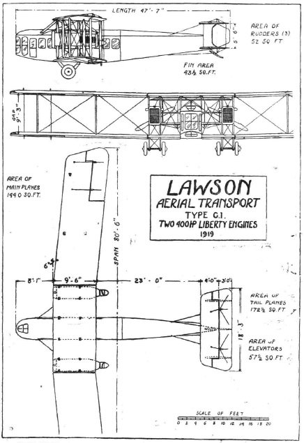

Lawson C1 = 1919 Lawson Aerial Transport passenger a/c
- C1 : aka T-1; commercial a/c proof-of-concept; no details
- C1 : 2 x 400 hp Liberty 12 V12 engines; span ~24.38 m
- C1 : Is this Aerial Transport PoC & L-1 the same (?)

Lawson L-1 = 1919 Lawson Aerial Transport aircraft; x 1
- L-1: Single-pilot; 10 passenger cabin airliner; 2-bay biplane
- L-1: 2 x 400 hp Liberty 12 V12 pusher props; span 24.53 m
-- L-1 is likely the same aircraft as the Lawson C1 (aka T-1)

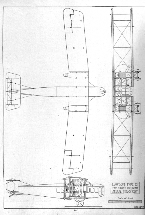

Amazing work as usual my dear Apophenia,
and from old encyclopedia,there is a big possibility to call C-1 as L-1.

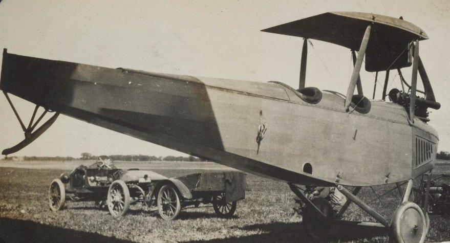

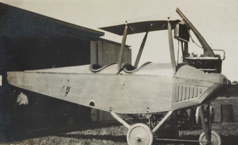

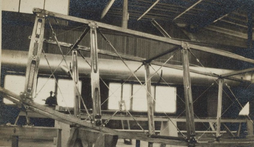

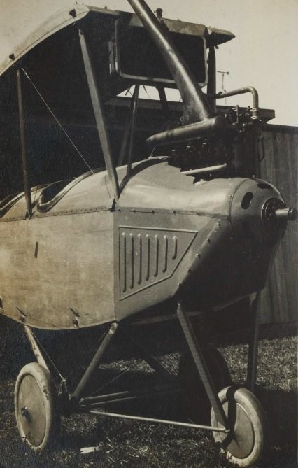

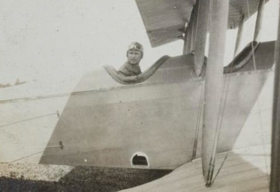

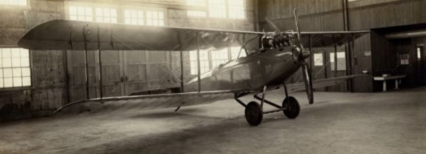

As mentioned above, this thread has addressed other Lawson projects, which may require a title change to "Lawson Aircraft Projects." Below are photos of the Lawson MT-1 Military Trainer.

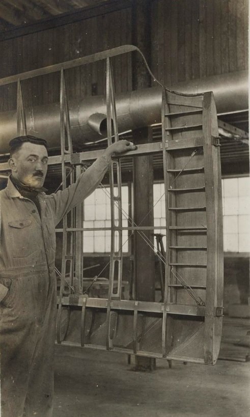

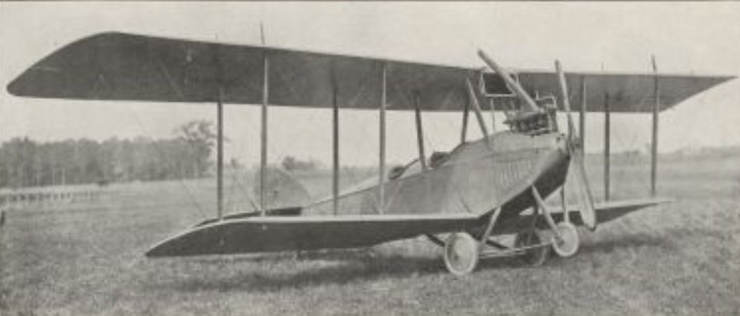

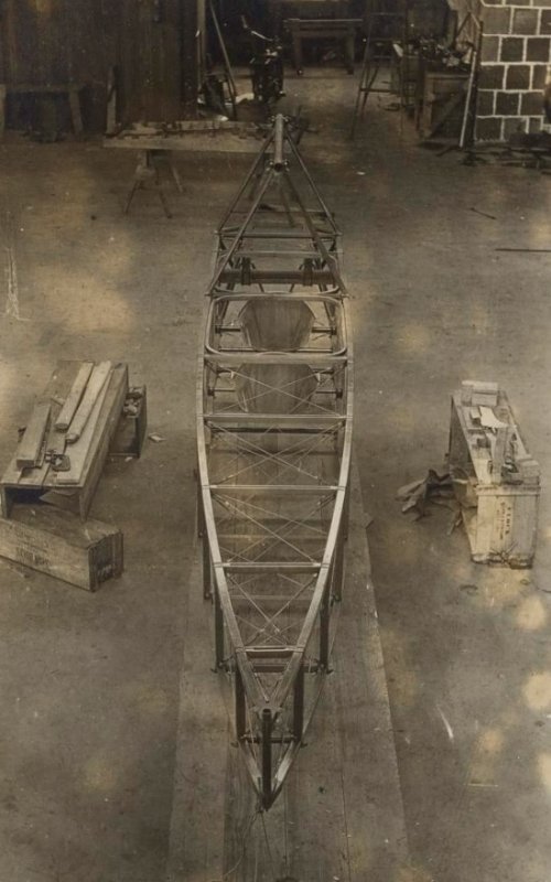

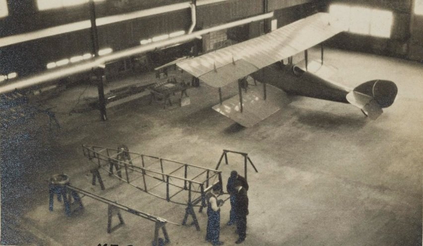

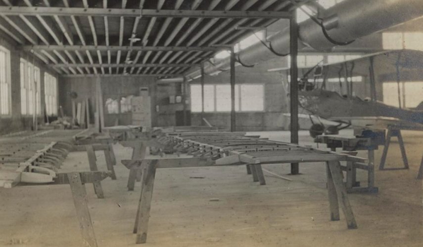

MT-2 Military Trainer under construction (note MT-1 in background).

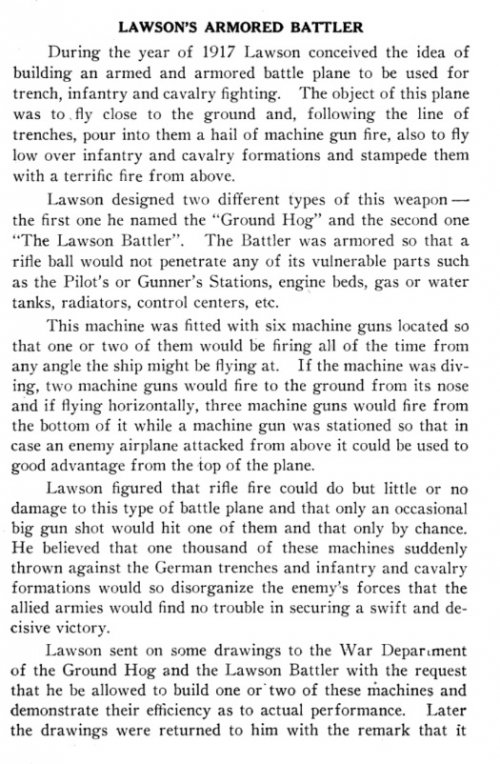

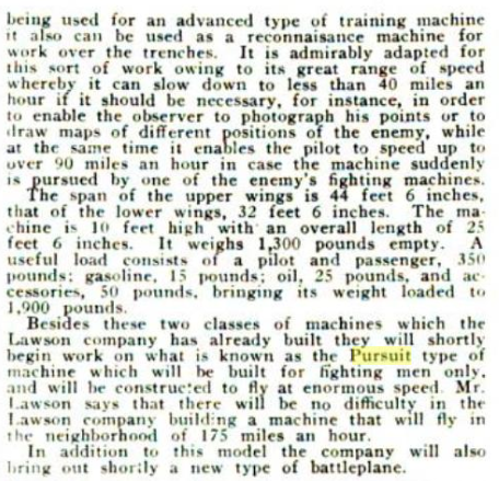

From the Airliner and Its Inventor, information regarding the "Lawson Battler." It appears that the Ground Hog may have been a heavily armored variant of the Battler.
