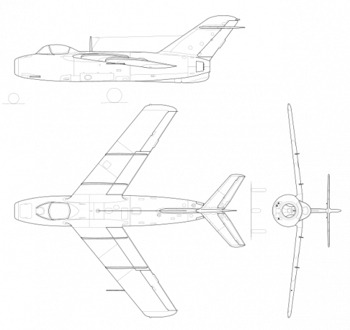

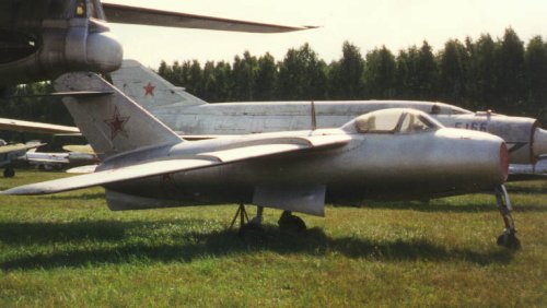

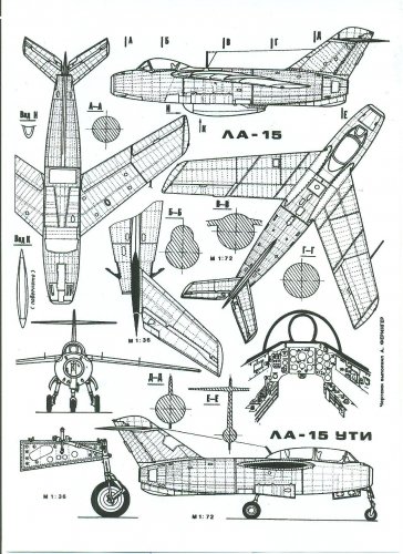

Competitor to the Mig-15. Like the design. Lost to the Mig-15. Was the reason it lost true, or for political reasons with bias given to the Mig? The cockpit failure and tail vibration sounds like a cover story.

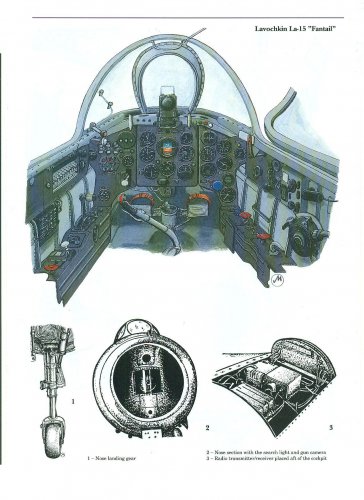

Any pictures of the cockpit, etc?

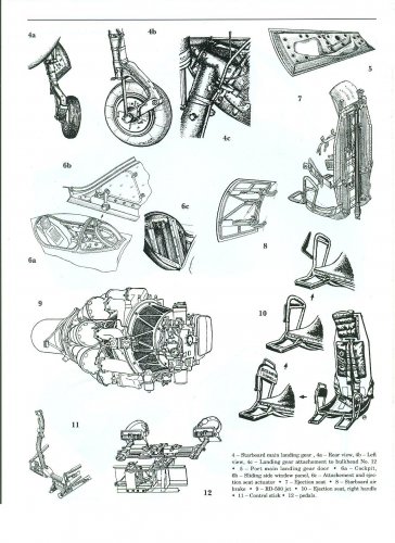

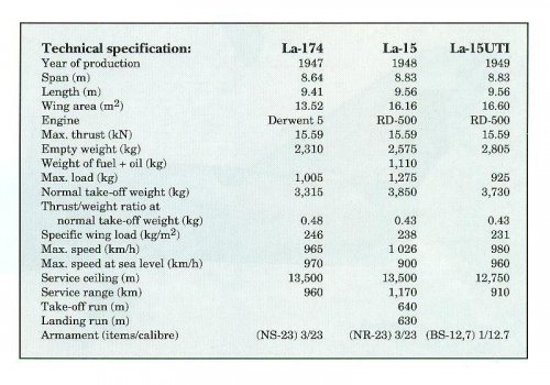

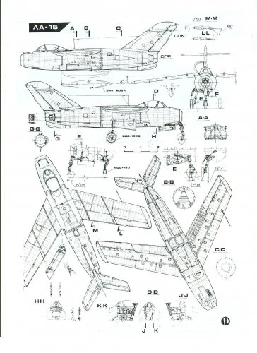

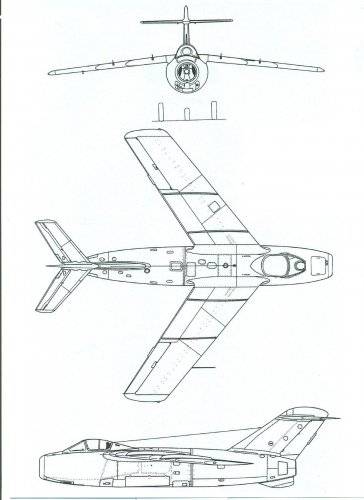

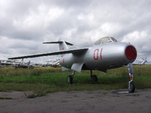

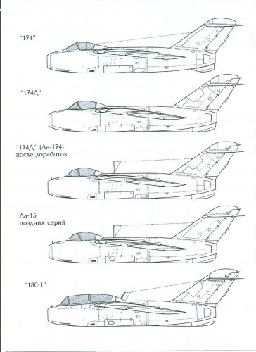

La-15 info...

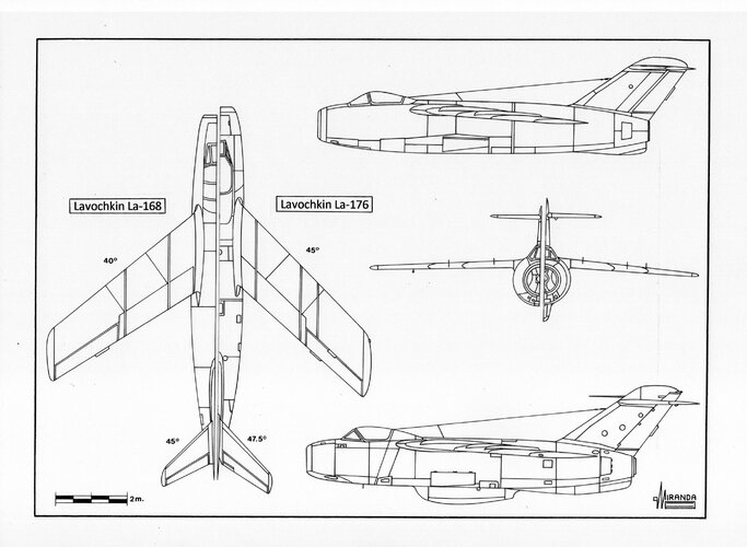

I have read that the La-168 (the original design that competed against the Yakovlev Yak-30 and Mikoyan-Gurevich I-310 (MiG-15)) was in fact a better performing aircraft than the winning MiG I-310 design. But it was deemed that the La-168 was more complicated and expensive to build (as well as the I-310 being thought to be more rugged design)!
I have personally always liked the esthetic look of the La-168 over that of the MiG-15. But my one greatest failing of the La-168 would have had to have been its extremely narrow track main landing gear arrangement - especially for the Russian's acute recognition and desire for rough-field operations! (I cant but help reflect on the experiences of the Bf-109 / Spitfire landing stability issues!!)
P.S. I also find it very interesting that the La-172 - a lighter frontal fighter powered by the Rolls-Royce Derwent turbojet. In essence a scaled-down version of the La-168!
What I find interesting with this lighter/scaled down take on the La-168 is the already apparent difference in size and weight of the La-168/MiG-15 to that of the then 'best' Western equivalent fighter - the NAA F-86 Sabre!
I've put together this comparison to emphasis the differences in alike designs!
Regards
Pioneer
