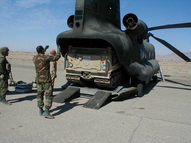

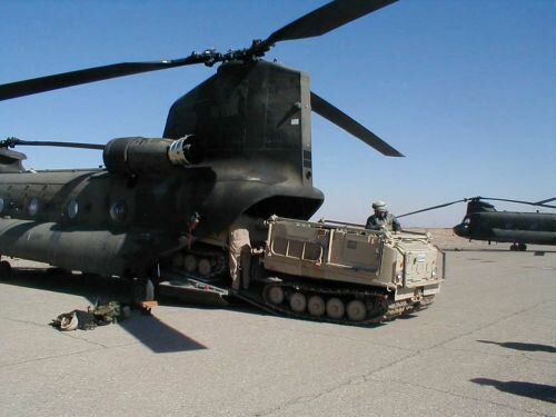

Interesting. Much of RAFG's support helicopter force would have been tied up to move mines about. (unfortunately don't have Air Staff and The Helicopter with me, it's in there).
Surprised to see that a Bv206 fits in a Sea Stalion. Could it fit in a Chinook? Did that influence the choice of Sea Stallion over Chinook?
Take a skilled driver to get it in!
Chris
Yes.

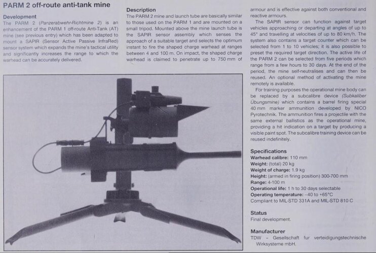

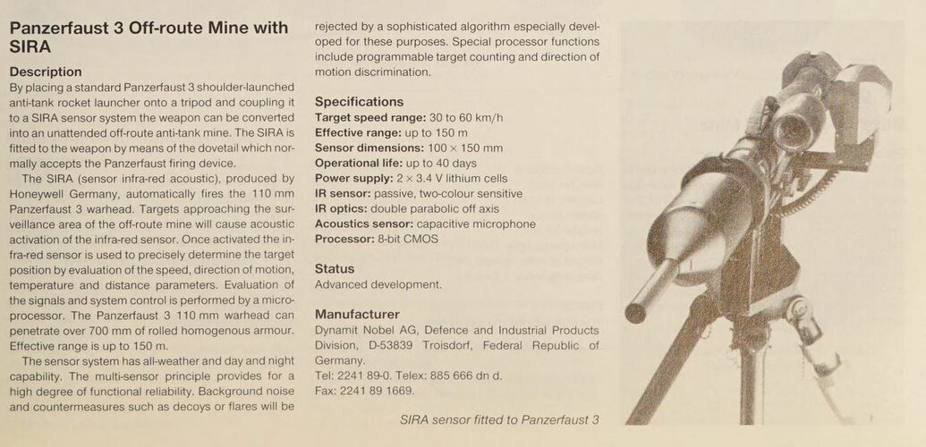

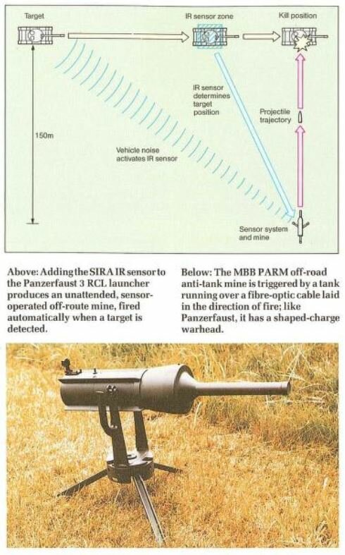

found more information and a picture

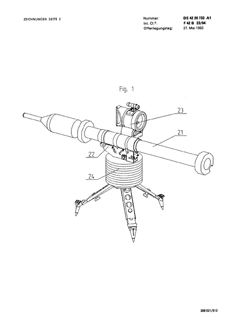

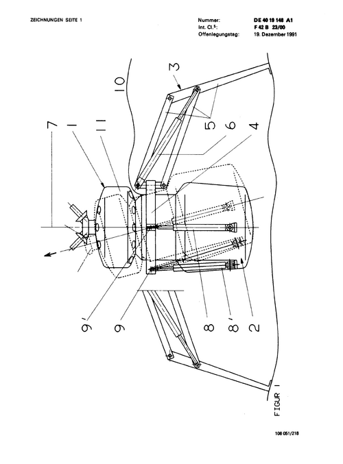

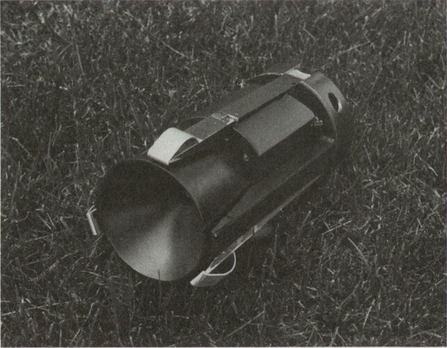

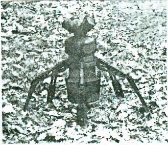

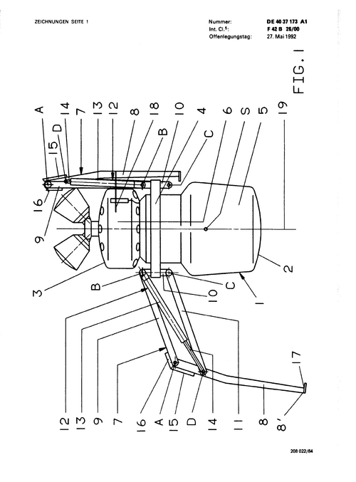

Im having a really hard time finding any good sources on the Tarantel mine and its weird look confused me, so i finally had to resort to Patents. Luckily i found two(1,2) that seems to show the mine:
The purpose of the weird long spider legs is to keep the mine vertical independent of the ground it stands on and to potentially be able to incline the mine in the direction of the target to increase the range.
The part above the legs is the vertically ejected munition.
The sensors that trigger the ejection of the submunition seem to be external and connect to the mine by the cable labeled 10.
But i still dont know anything about the munition itself. The three little horns on top of the muntion shown both in the pictures and in the patents look like the sensors, but are they infrared or sound or MMW radar? And how does the munition modify its trajectory? Also the submunition looks nothing like SMArt, so maybe the BITS Report is wrong about that, although there are other sources that confirm that the Rheinmetall Cobra mine uses SMArt.

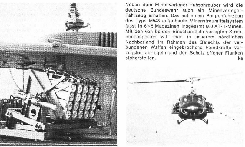

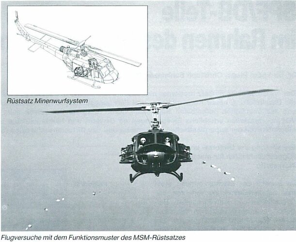

and an photo of the Daynamit Nobel AT2 mine being lauched from a UH-1D
Dornier project for a helicopter mounted mine-dispersal system

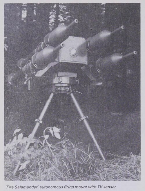

Not sure if this is technically a mine, but i think it fits anyway:
The 'Fire Salamander' was a Dynamit-Nobel Panzerfaust-3 remote-control quad mount

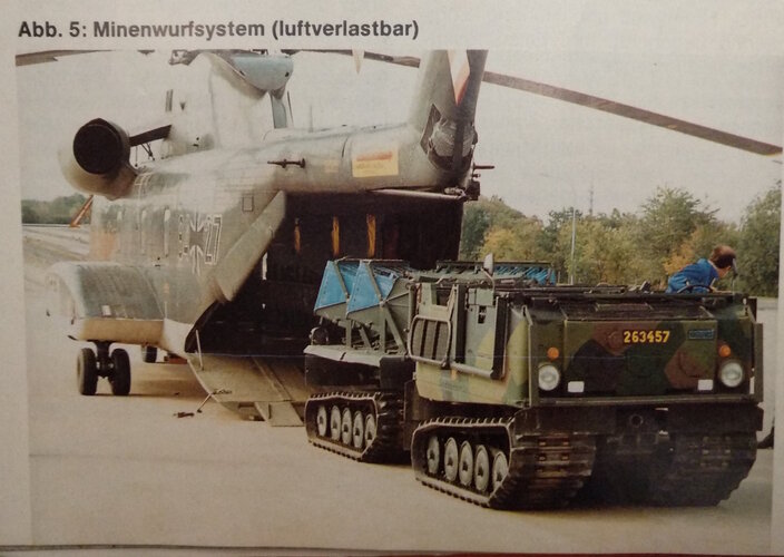

Found an article with the original color versions of both of these images in Soldat und Technik 8/1992
I would guess this is the original source for the Hungarian article.
The article also mentions the Rheinmetall COBRA area-defence-mine but unfortunately doesnt provide a picture.
In the same issue there is also an ad by Dynamit Nobel showing all their mine projects including the TARANTEL and the ACEATM directional mine developed by a European ARGES consortium (Dynamit Nobel, Honeywell, GIAT, Hunting)

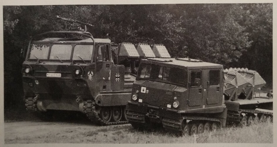

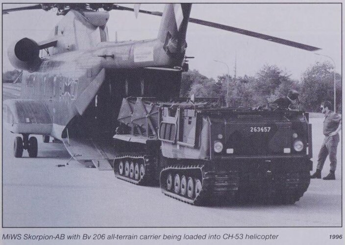

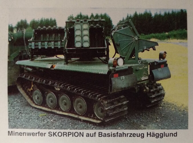

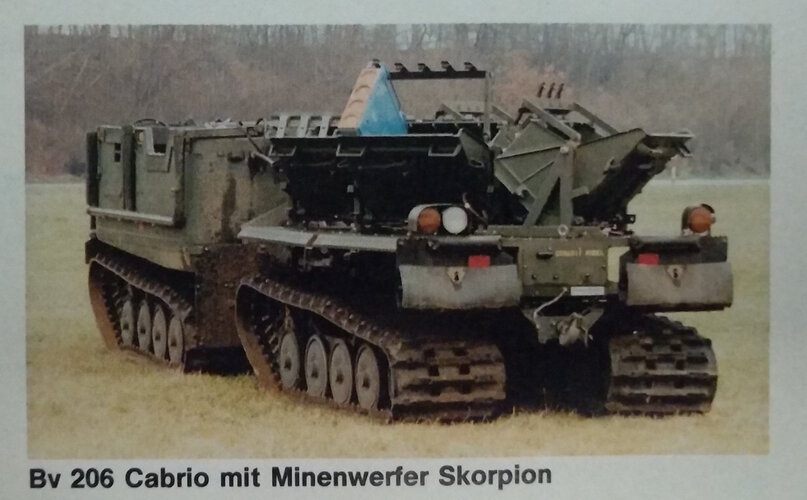

Found lots more pictures of the SKORPION system on the BV206

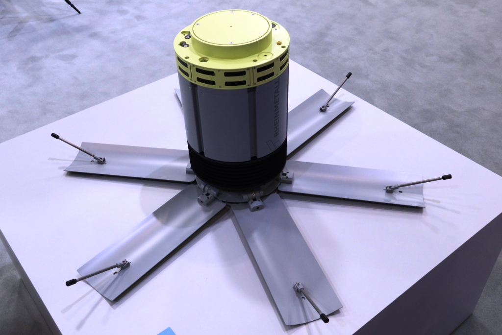

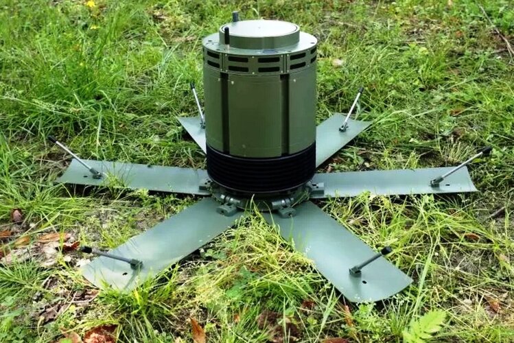

Still havent found a picture of Cobra but Rheinmetall seems to have brought the concept back under the name Area Defence Weapon (ADW):
Towards the end of the Cold War the German Army was looking for a barrier concept to stop the mass of Soviet and Warsaw Pact tanks that might have attacked its borders, the main potential tank playgrounds being the Fulda Gap and the northern German planes. Beside standard antitank minefields, airmobile formations capable to funnel Red Army Operational Manoeuvre Groups into combat helicopter killing grounds, the idea of a barrier made of smart land-based mines able to attack the weakest point of an MBT, the top, started to appear. Nothing came to fruition, and the concept never became a product, financing being stopped in the late 1990’s when other types of missions became the bread and butter of most western land forces.
Since February 24th, 2022, things have consistently changed, and old ideas come back on the computer screen. It is the case of the ADW that is being developed by Rheinmetall Weapons and Munitions (RWM), and which was unveiled in late August at the RÜ.NET 2023 that took place in Koblenz, Germany. The system could be seen by a much wider audience two weeks later in London, at the DSEI 2023 exhibition.
