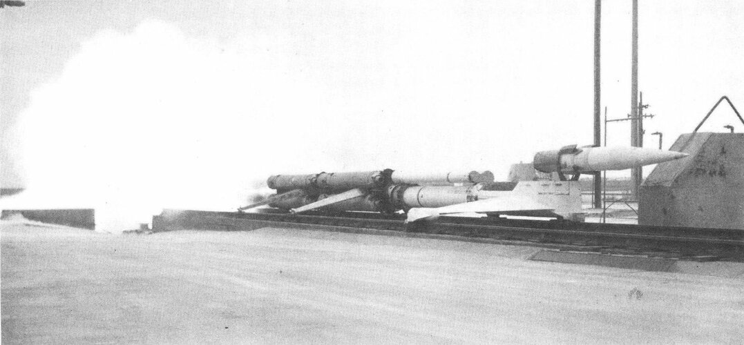

Fully-powered USAF Aero Propulsion Laboratory low-altitude, short-range missile sled configuration is shown during test run. Test vehicle consists of one payload sled with Terrier Mk. 12 solid propellant rocket motors with two Recruit motors mounted on top.

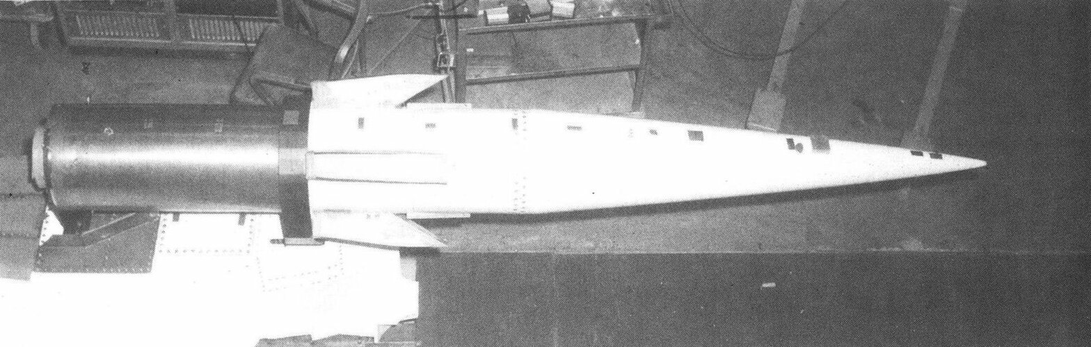

LASSRM-1973-2.jpg LASRM ramjet propulsion test vehicle was assembled at Holloman AFB prior to first rocket-powered run conducted by the 6585th Test Group of USAF's Aero Propulsion Laboratory. Note three of four aft-mou nted inlet projections.

Test run No. 5 failed to achieve ignition and a seventh run was added to the ramjet sled test program. There also is a possibility that an eighth test will be added to the program, according to APL project engineer Lt. Jerry L. Ross. The personnel. equipment and facility are still available should a sound reason arise. The first sled test was run at Holloman test track on Aug. 4. It used a shortened
forebody (67 in.) for greater stiffness to test the loads. It ran on a single (sustainer) sled powered by a Terrier Mk. 12 Mod. 1 solid propellant rocket motor. Velocity objective was 1,500 fps. and the sled reached a maximum speed of 1,760 fps. (about Mach 1.5). A brief rundown on the other sled tests shows:
I Second test ran on Sept. 20 with a full-scale forebody. Again the sustainer sled was powered by a Mk. 12 Mod. 1 solid propellant rocket. A pusher sled with two Terrier Mk. 7 solid propellant rocket motors was used to push the speed to 2.000 fps. Nominal objective was 2,100 fps.
I Third test run Oct. 26. It used two pusher sleds each carrying four Terrier Mk. 7 motors in an all-out attempt to reach 2.700 fps. (Mach 2.4 to Mach 2.5, depending on type of day). This sled train (each stage drops off after motor burnout leaving only the sustainer stage with LASRM forebody and burner) reached a velocity of 2,445 fps. (about Mach 2.2), which was not sufficient for starting the, inlets, which were designed to start at Mach 2.3.
I Fourth test ran Jan. 17. For this test, two solid propellant Recruit rocket motors were mounted on top of the Mk. 12 sustainer sled motor. With these 11 rocket motors, LASRM reached a velocity of 2,820 fps. against a predicted 2,825 fps. It was still a cold flow test but inlets were started and the ramjet ran for 3.6 sec. at speeds above Mach 2.3. APL ramjet engineers said that in addition to inlet start, they got a good set of cold flow data on the ramjet engine; the braking system worked fine; loads were within design limits, and the test time and velocities were right.
All LASRM forebodies were full-scale after the first run.
Total Thrust
Total thrust generated by the 11 solid propellant rocket motors during a test run is 530,000 lb. The total of eight Terrier Mk. 7 rockets on the two pusher sleds produced 400,000 lb. thrust (50,000 lb. each) for 3.5 sec. The Terrier Mk. 12 sustainer on the payload sled burned for approximately 4 sec. and generated 70,000 lb. thrust, and the two Recruit motors produced 60,000 lb. thrust total for the 1.6 sec. they burned.
I Fifth test, which ran Feb. 15, was supposed to be the first hot test but ignition was not achieved. The squib valve that was to release triethyl borane ignition fluid failed. Test vehicle configuration was the same as in the previous test and the sled reached the required velocities above Mach 2.3.
I Sixth run, on Apr. 6, achieved ignition and the ramjet combustor operated stably for approximately 3.5 see. above Mach 2.3. In this test, LASRM ran at zero angle of attack using the same configuration of two pusher sleds and 11 solid propellant rocket motors as in the previous two runs.

The original SCP/LASRM ramjet engine was designed to cruise at a 1-deg. angle of attack over a very small mission envelope.
Inlets available today are much superior to those on LASRM and would enable new ramjet or rocket/ramjet-powered missiles to operate over a much broader mission envelope and angle of attack range, according to Aero Propulsion Laboratory researchers.

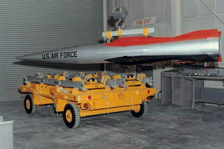

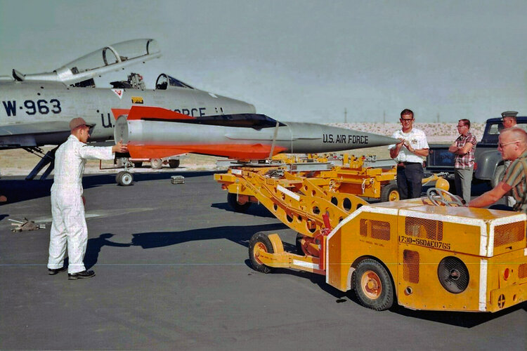

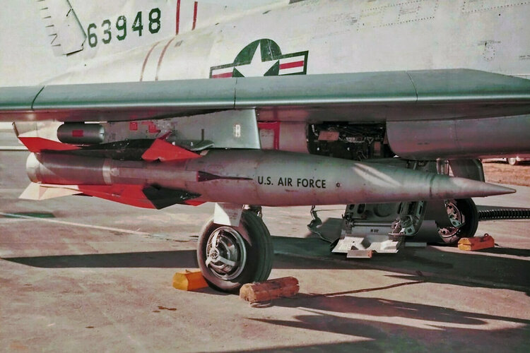

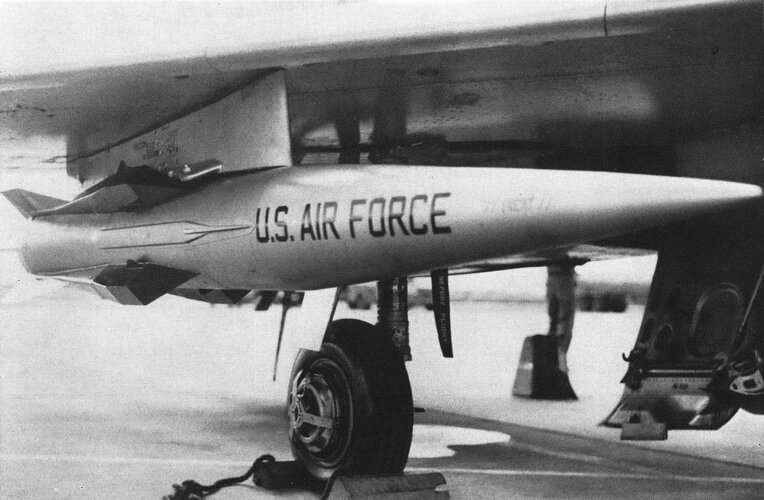

Low-Altitude Supersonic Missile

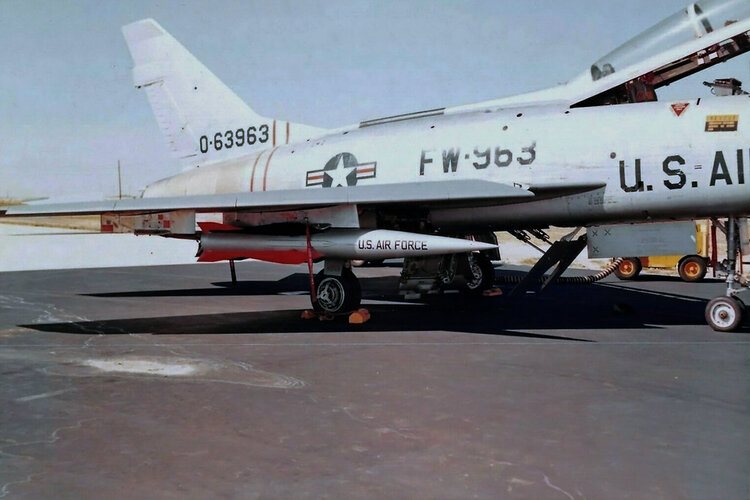

Marquardt low-altitude supersonic missile (LASV), shown mounted beneath the wing of a North American F-100, is undergoing flight tests at White Sands Missile Range, N.M., for the Air Force Aeronautical Systems Div. The weapon is also called low-altitude short-range missile (LASRM). Its two-phase propulsion system comprises a ramjet engine for highspeed flight and a Thiokol solid-propellant rocket mounted in the ramjet nozzle. On firing, the rocket boosts the missile to ramjet operating speed. Ignition of the ramjet blows rocket from the nozzle. Before ignition of the ramjet, covers on the air inlets, forward of the fins, are ejected. The missile has been flown five times in the Marquardt development program. The sixth and final flight in the current program is scheduled for the latter portion of the month.
