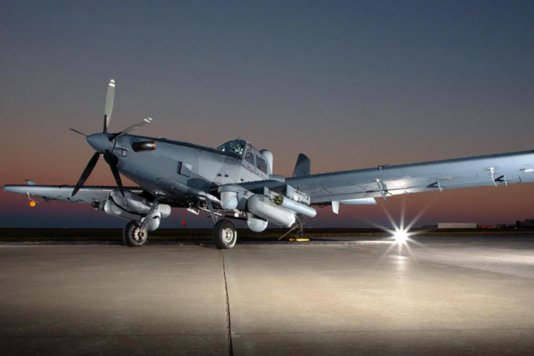

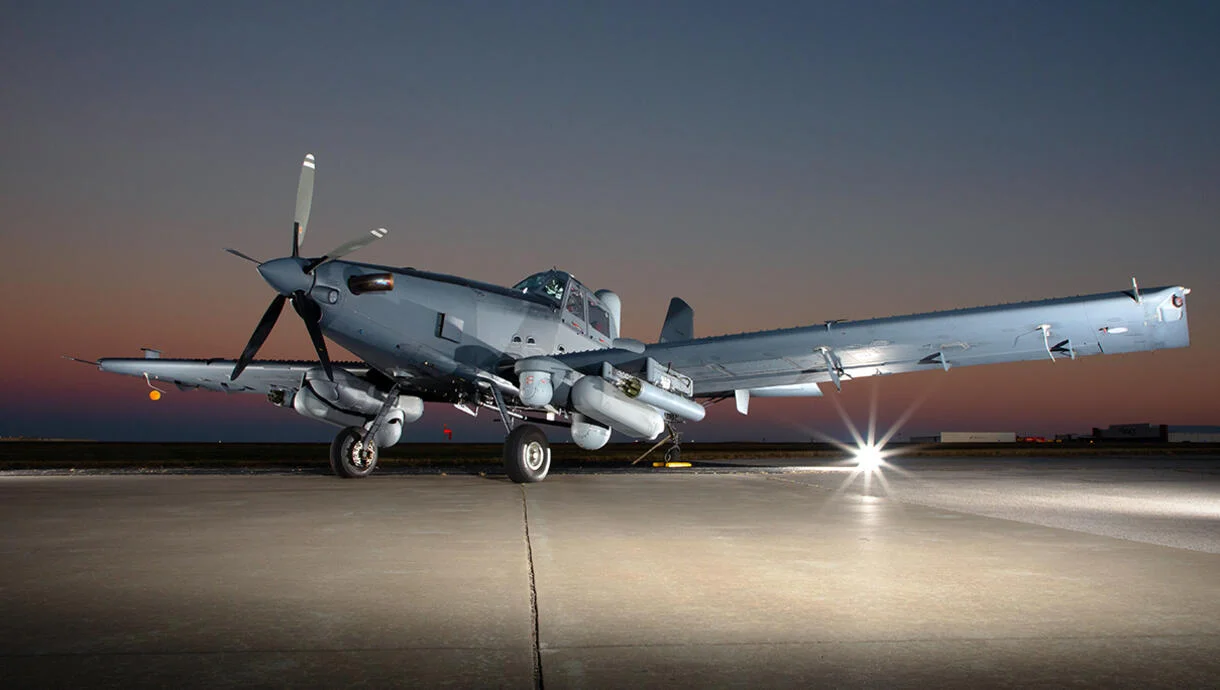

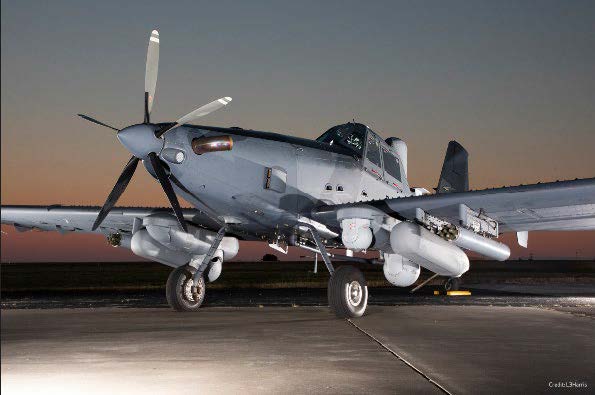

L-3 Harris Sky Warden (combo with AirTractor At-802) for USSOCOM Armed Overwatch program for sub Saharan continent

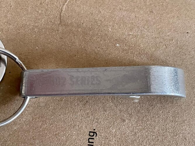

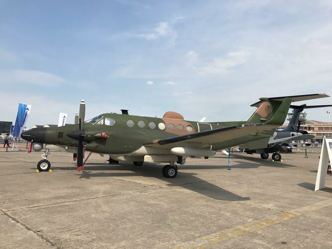

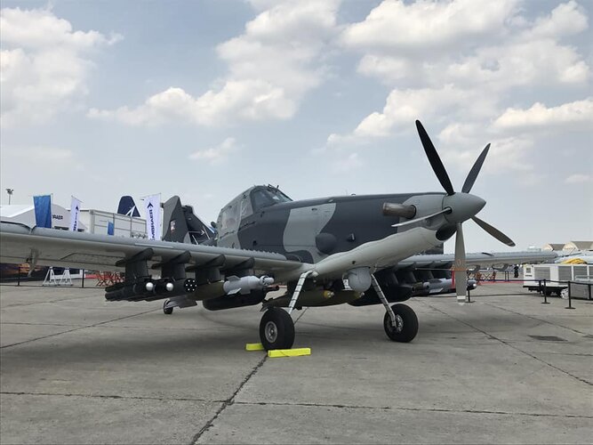

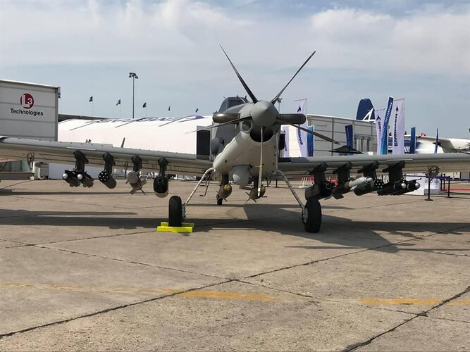

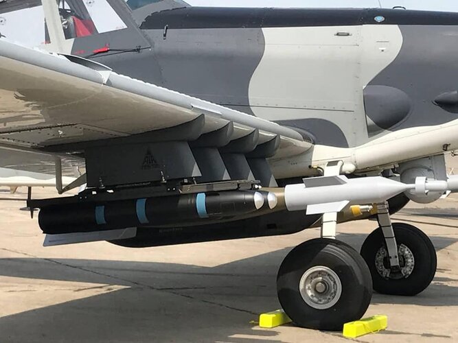

TBT Paris Air Show 2017 and I wandered over to the L-3 chalet so here are pics of At-802 plus swag in the form of a bottle opener! Very useful for nights out! L_3 also had their ISTAR King Air 350 on there
cheers

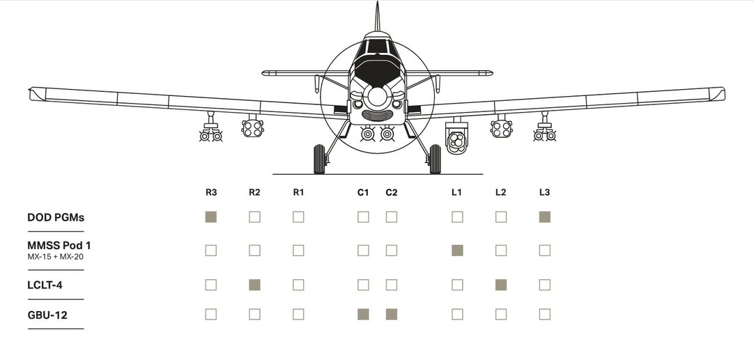

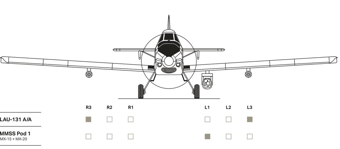

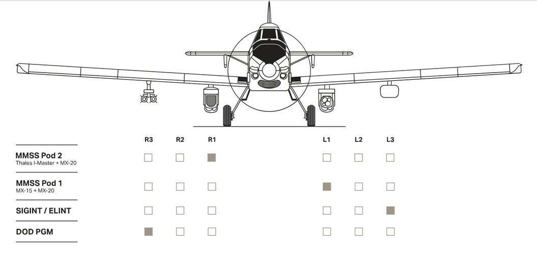

Diagrams of the "standard" payload options from the Air Tractor website (Sorry that the headings got lost -- the website wouldn't quite fit the whole image on my screen):
The Max Strike load is interesting, IMO. The LCLT-4 pods are quadruple Common Launch Tube pods, which you can see in the first photo in the thread. The unusual thing is that they have aft-facing tubes for launching/dropping glide weapons rather than ahead-fired missiles. But SOCOM has a lot of these sorts of weapons, so it fits their use case really well.
The Max ISR config is also a bit unusual. The MMSS Pod 1 config already includes two FLIR balls -- one MX-15, which I assume is for the pilot, and a larger MX-20, which is probably for the sensor operator. MMSS Pod 2 adds a second MX-20, presumably so the sensor operator can look off both sides of the aircraft track at once, and an I-Master radar for 360-degree radar coverage. Plus ESM/SIGINT in another pod. And a pair of Hellfire/JAGM for "see something, kill something."

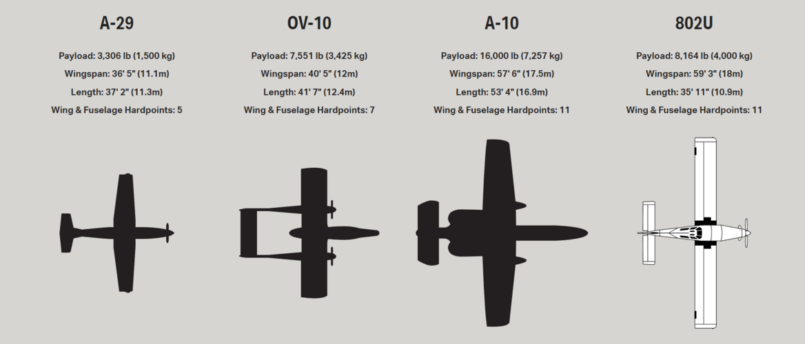

If one is operating in a low intensity environment in a COIN style role this makes more sense than an A-10.
It's especially tailored for ops in places where SOF are operating without any conventional forces present. So, mainly Sub-Saharan Africa or possibly parts of Asia (the Philippines has been mentioned).
I think it's an outstanding design but a lot of those ops request something that can transit to the operating area (and back to reload) fast. I am not convinced that SOC got this here.
Also, what about takeoff limitations with all that much vaunted war load?
From the manufacturer, with the heaviest "surveillance & weapons load," gross weight is 14,500 lbs (6,600 kg) and the takeoff run is 1,400 ft (426 m). They are not proposing to load it out wall-to-wall as a general rule.

Speaking of which, Paris Air Show 2017 I popped by the L-3 chalet and here are my photos of their armed Airtractor
