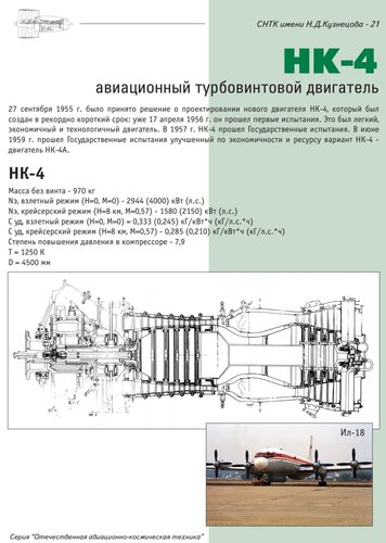

Is there any information, specifications, and/or pictures of some of these engines?
TV-2 turboprop
NK-4 turboprop
P-8 turboprop
NK-6 turbofan
NK-10 (turbojet?)
P-4 turbofan
NK-15 turboprop
TV-2, NK-4 and NK-6 are covered in this series of articles on the history of Kuznetsov:

Yes, but those are P-4 (NK-4?) turboprops. And it’s not really a bomber, but more of a composite bomber mated with Tupolev ‘Aircraft 100’. There was a bomber version of ‘Aircraft 108’, but it had turbofans instead.
Do you have any any performance parameters for the NK-4 and P-8 turboprops? The Tupolev 'Aircraft 108' is mentioned in the book about soviet secret bombers (by Buttler / Gordon) but there is no detailed information about the turboprop variant which shows a typical transsonic / supersonic layout with its delta wing, area ruling and Kuechemann carrots. It is amazing Tupolev investigated a supersonic design using turboprop engines. For sure it would have needed supersonic propeller profiles.
So the NK-4 cannot be the proposed propulsion for the Tupolev Aircraft 108. Is there information available about the turboprop of the "Aircraft 108"?
The P-8 isn't the NK-4. The P-8 was a Kuznetsov study for more fuel efficient engines. The P-8 'RVD' is probably better translated as a "propjet", it was hybrid between a turbojet and a turboprop with more emphasis on the jet thrust component than a standard turboprop. Its not a million miles from an unducted fan engine. There was also a turbofan version of this engine. Other engines explored included Mikulin AM-17, Dobrynin VD-5M and VD-7M, and Klimov VK-9F.
