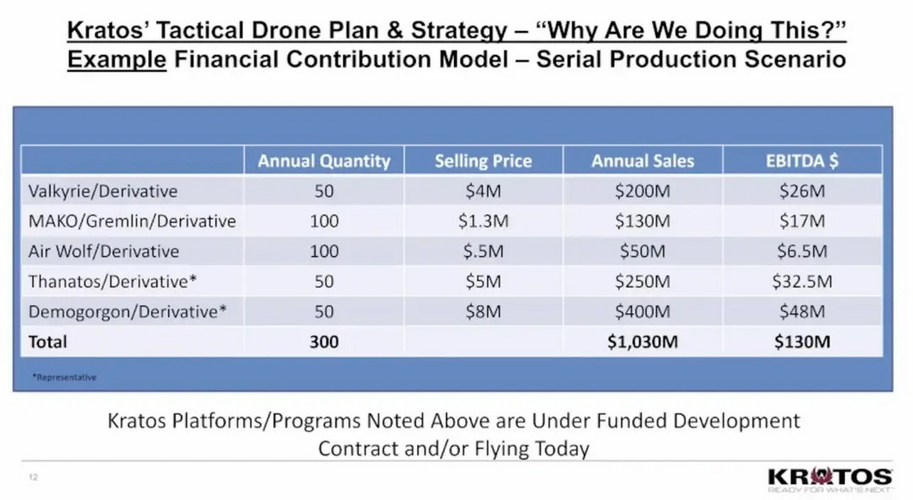

Got to be smaller, IMO. They are talking about a selling price on the order of $5 million per aircraft.
Agree. I suspect the XQ-58 is just a little too small for the USAF's goals. The USAF recently put out a RFP for engines in the 3000-8000 lb thrust class; XQ-58's engine is believed to be ~2000. Thanatos likely is a UAV more in that desired USAF thrust class, either with two smaller engines (advantages to using the same engine across platforms) or perhaps one more powerful one (is two engines confirmed or was it just suspected based on the dual inlet design?). I would also suspect one of the goals of a CCA platform would be to carry ~ 4x AIM-120 sized AAMs, and I think the Valkyrie would struggle with the weight of that load and length of such weapons.
