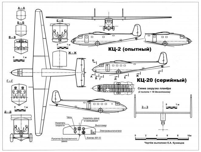

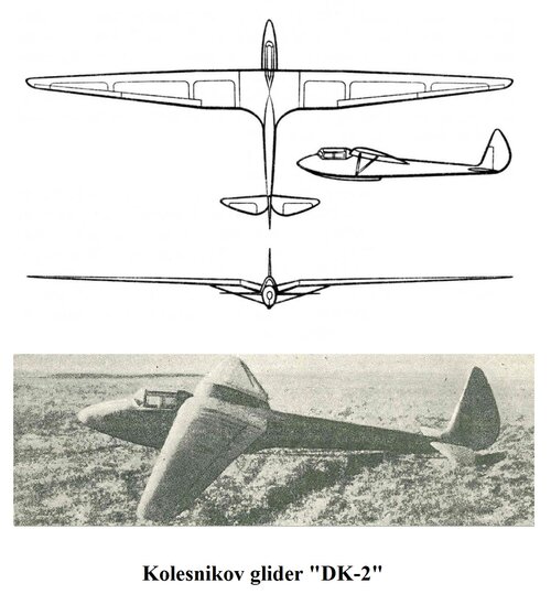

we know the Russian designer D. Kolesnikov and he created many gilder and assault gilder
aircraft and projects,here is a drawings to KTs.2,KTs.10 and KTs.20.
Kryl'ya Rodine 11-12/2013

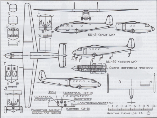

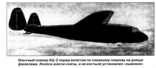

here is a Kolesnikov KTs.2 glider picture,with a strange drawing to seaplane version,land on water
glider.
Десантные планеры Сталина 1930-1955 гг. "С неба - в бой!"

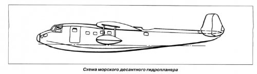

PS I think the water-glider shown in Hesham's post could be the KTs-20 Gidro project from 1944 (see attached).
