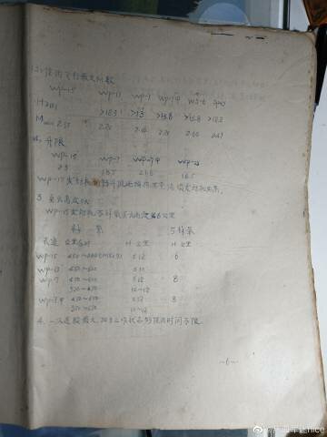

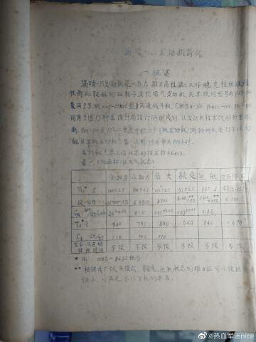

Basic information on WP-15, Chinese domestic copy of the R29-300 (with modifications?)
