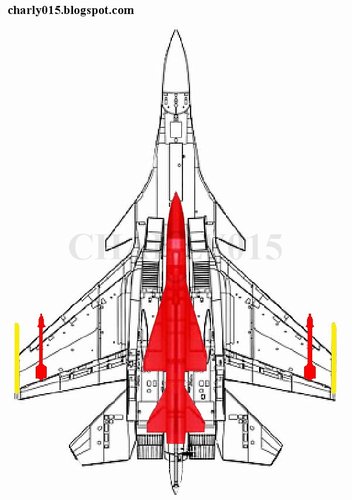

Any idea as to what hard points the Kh-32 missile will be fitted to the Su-30? I cannot see the missile getting fitted to the hard points under the intakes as it is a big missile.
I used drawing of Su-30MKM, but it is the same size

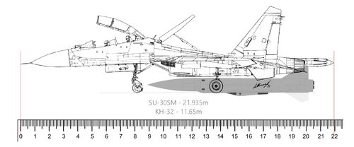

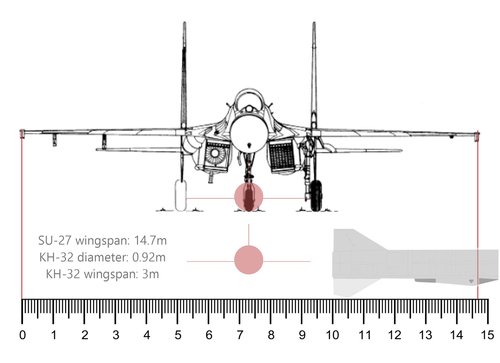

To my estimations the KH-32's wings would intersect with the aircraft's landing gear and then there's the upper vertical stabilizer that doesn't fold (unlike the lower one) so the whole thing would just scrape on the runway, not even taking into consideration CG issues and rotation upon take-off.
