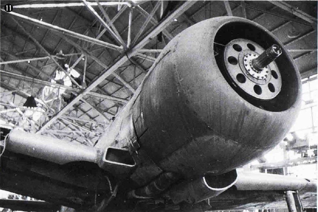

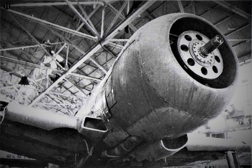

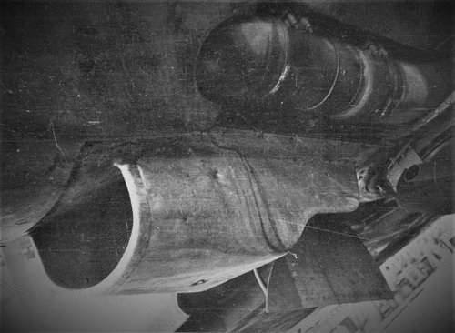

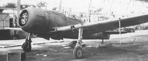

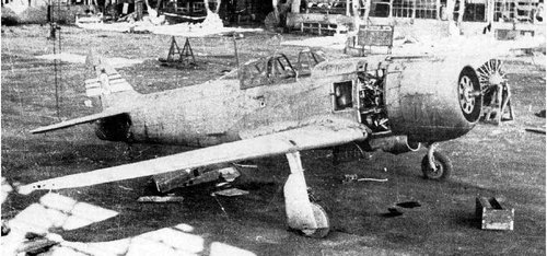

Wasn't at least one of these found intact after the Japanese surrender, there are a few photos online purporting to be of the Ki-100-II, e.g. these, which appear to show the correct intake arrangement and I think the Turbocharger piping under the fuselage is visible:
: ki100-11.jpg Ki-100-II_i.jpg Ki-100-II_ii.jpg
Thanks a lot JFC Fuller-san. These pictures are absolutely what we want to see!!:oops:
Ki-100Ⅱ did not have intercooler. She had water/methanol injection system instead.
