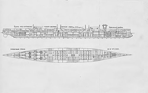

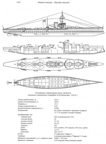

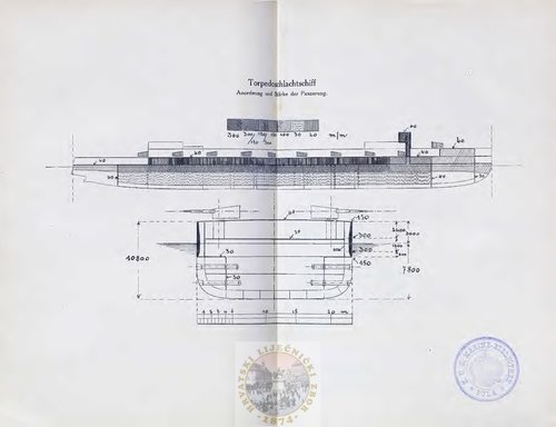

Here is another rare one... with 84 torpedoes stored in submerged tubes this is a candidate for the largest torpedo load proposed. It would certainly be a nasty surprise.
613461
However, the actual weight of the running torpedoes at 50-60 tons is outmatched by that later Kuma class cruisers (108 tons). This is due to the much smaller size of these torpedoes (assuming dimensions of typical whiteheads). Even the Shimikaze could release a larger broadside as it could turn all of its tubes to release a single broadsie of 40.5 tons (compared to that of the 42 torpedoes at a total of 25-30 tons). Of course the Type 93 was also much longer ranged, more reliable, more accurate, and carried a proportionally more devastating warhead. So Japan would still carry the title in terms of overall effect if not in terms of absolute numbers.
I remember seeing that Russian torpedo battleship on the old Warships 3.0 board and I will make the same remark I made back then. It is one of the few 'Torpedo Battleship' designs that didn't end up looking like an overgrown destroyer.
Imagine it in World of Warships, say as a Tier 3 Premium. The screams would be heard in orbit.
That's a lot of underwater holes just waiting to happen.

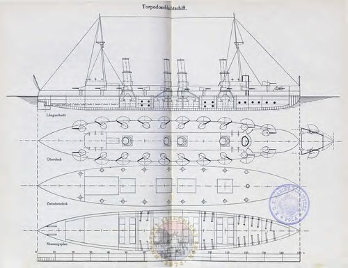

That is if I'm not mistaken the Austro-Hungarian idea for a torpedo warship

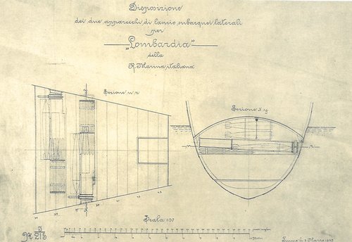

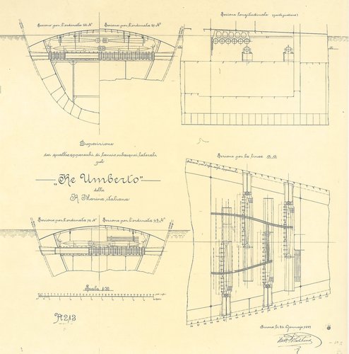

Hi, a couple of figures and a caption form the Italian book "Sotto i mari del mondo. La Whitehead 1875-1990", Laterza Ed., 1990, dealing about the history of the Whitehead torpedo factory.
The caption briefly describes the two underwater tubes on the "Lombardia" (a cruiser launched in 1890) and the four underwater tubes on the "Re Umberto" (an ironclad launched in 1888).
