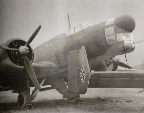

In "Junkers-Pictorial Record Of All Aircraft", I've found a photo of a Ju 86E, said to
be used in a training role and fitted with a nose raome instead of the nose gun turret.
Any idea which radar it could have been ?

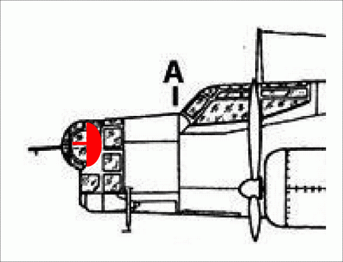

Assuming that is a radar housing, the only one that comes to mind that would have that sort of installation is the FuG-240 Berlin with a parabolic antenna- the other German airborne radars that I can think of used external dipole aerials. Only a couple of dozen sets were built before the end of the war.
