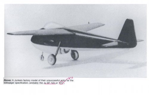

From "Jet Planes of the Third Reich -The Secret Projects-Volume one " by Manfred Griehl, Monogram.1998

The only reference I can find to the EF 123, apart from the one you already have, is from Heinkel He 162 Spatz - Balous & Bily - MBI.
The commision rejected the proposals from Junkers "Whose aircraft, possibly designated EF 123 or EF 124, was too simple. However the main problem with the Junker's proposal was the engine attached in a nacelle and fixed under the fuselage."
That description seems to match the photo of the model in LSPF, but not the artists impression.
Regards Bailey.

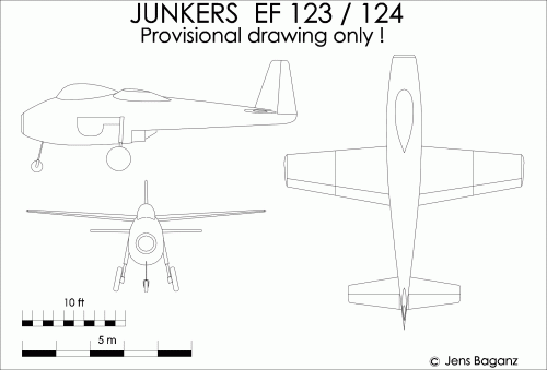

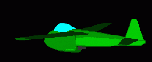

Judging from descriptions and drawings there may have been more than
superficial similarities between the EF 123/124 and the later designs EF 126
and 127 (wings, cockpit and landing gear). So I used them and the photo of
the model as a basis for a reconstruction. Just an attempt, source grade 2 .

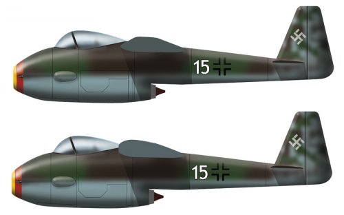

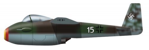

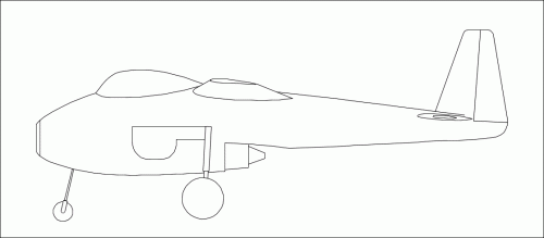

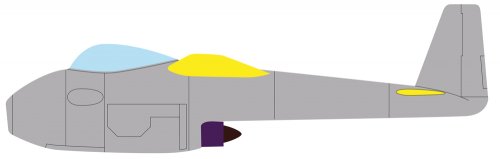

Hi
I've tried to re-profile the area above the engine exhaust as a remedy and to avoid any 'sheetmetal mess'
more akin to the Fw and BV 211.02 entries. (?)
Cheers
P
Definitely better ! I had a closer look at the model again and I'm not sure, but the
fuselage underside just behing the nozzle seems to be curved upwards . Maybe the
underside was formed like a spade ?
Exactly what I was thinking about, thank you !
Such an arrangement could have led to an exhaust
like this, I think:
Thank you very much Gentlemen.
I'll do the spade-like thing.
Er?...something like this?
Many thanks
Peter

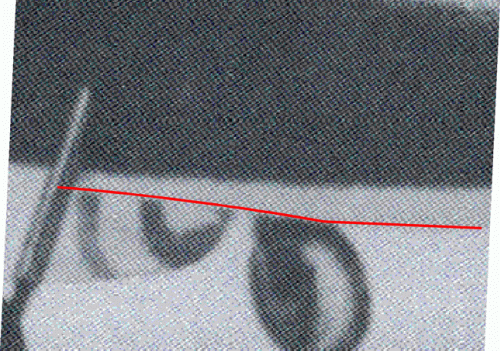

I would agree to Justos interpretation of the nozzle, the half retracted look
probably is an perspective effect in the photo, as the fuselage above the nozzle
is wider, than the nacelle. About the less swept leading edge I'm not quite sure,
made a quick experiment and i think, due to perspective and dihedral the sweep angle
of the leading edge COULD appear to be less, than it actually is.
(Sorry for the lousy graphics, but I had to take them from screenshots, I hope, they'll show,
what I'm trying to say :-\)
Thanks Justo and Jemiba.
I was sort of basing my first attempt on the illustration in
Luftwaffe Secret Projects: Fighters 1939-1945 by Walter Schick and Ingolf Meyer, PAGE 99.
I'll get busy. Corrections soon.
Peter

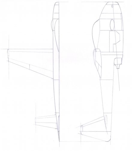

Hi again
I'll do the nozzle and fuselage profile as Justo has suggested.
And do one version for each of the two suggested wings.
Probably get something done over the weekend.
P

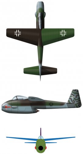

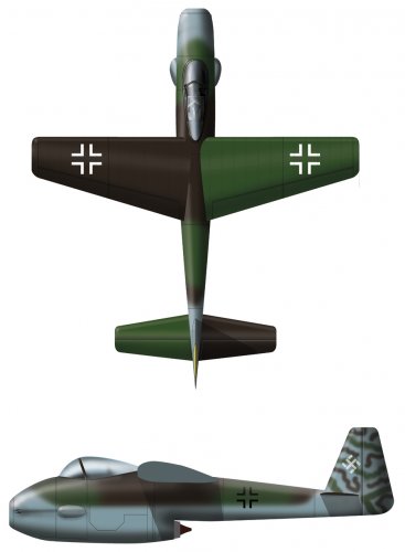

Hi
Side views.
2 versions, 1 of each wing type.
Top views next.
Cheers
P

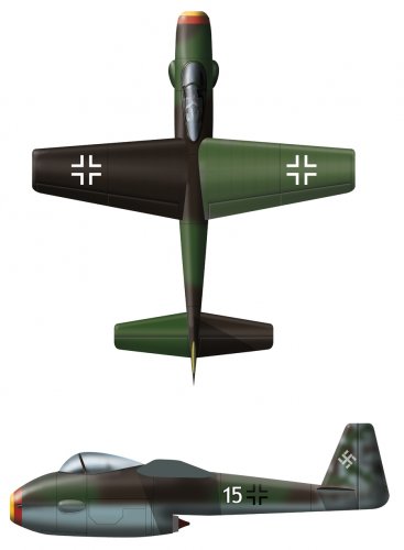

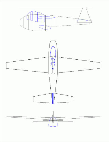

First top view tapered wing type progress.
P

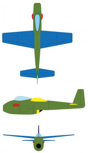

Hi.
Whilst doing the above profile I came to the conclusion that the straight leading edge wing as suggested by Justo is more than likely the correct one.
So this one is the possible alternative.
Question please.
Tail planes. Would these also be made of wood like the main wings?
Many thanks
P :)
Thanks Justo.
Now progress on the straight leading edge wing version.
Many thanks
P
A little more tonight.
Re-profiled the main wing on the side view etc.
Many thanks
P :)
