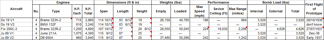

For what it's worth these are the specifications for the Do 19, Fw 200 and Ju 89 according to "Hitler's Luftwaffe" by Tony Wood & Bill Gunston, which is one of my sources for the above.
