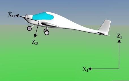

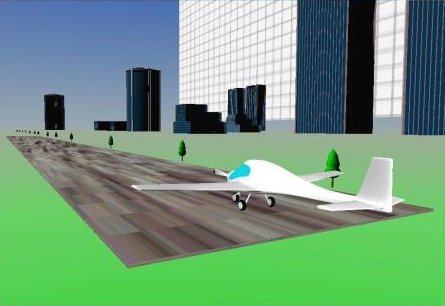

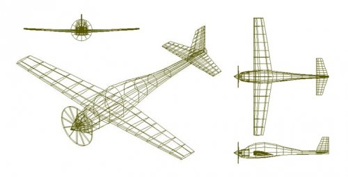

In the present study, design analysis is performed to accurately estimate the gross take-off weight, define the external geometry, and size the wings and tail of a general aviation aircraft by using the performance parameters associated with a pre-defined mission profile and a set of design goals. Three-dimensional layout and projections of the design airplane are created using conic lofting-based software. The airplane configuration, the estimated weight, and the real time airplane equations of motion are then introduced to a simulation environment in Matlab to visualize the take-off, climb and cruise segments of the mission profile.
The simulation has proven the adherence of the design analysis and its results to the design goals. In addition, finite element software package COMSOL is implemented to perform static stress analysis on the selected wing configuration when subjected to the generated aerodynamic loads to examine its structural reliability. The finite element results have shown that the selected wing configuration is a safe candidate for the present general aviation airplane implementation.
