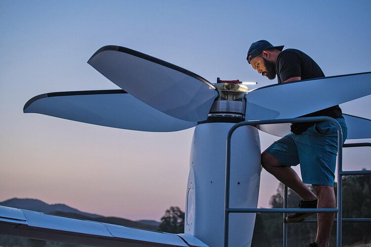

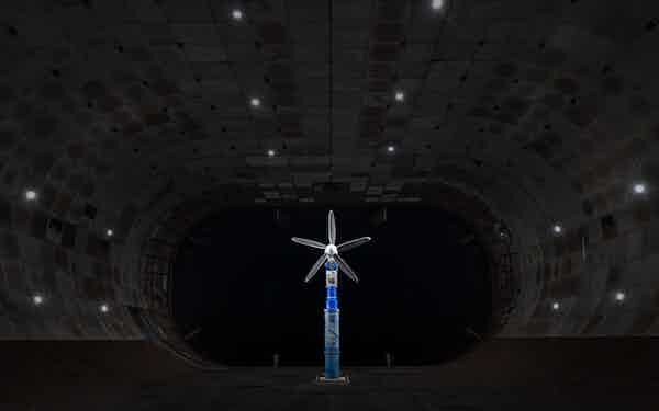

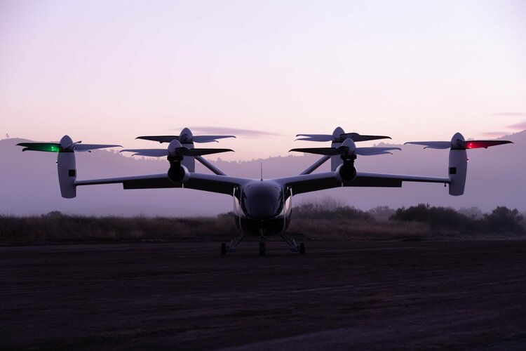

It looks like the propeller design, the composite, variable pitch controlled propellers and asymmetrically spaced blades, has been well-optimized. I'm hoping for favorable outcomes in that large-scale testing campaign.
