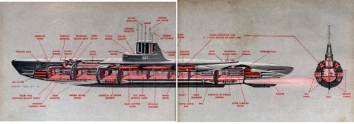

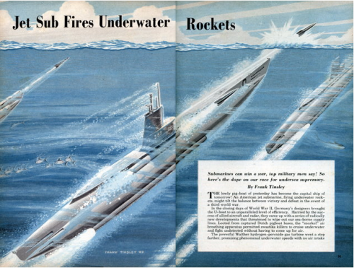

i Pasted the Submarine painting (center is missing in raw data)
art work by Frank Tinsley 1949

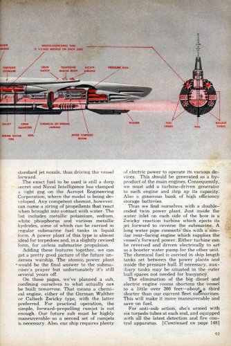

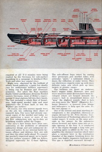

Under jet engine
A 1940s under water jet engine.Fritz Zwicky invented an underwater jet, ramjet working with fluid medium, under the US patent 2,461,79
I read that it was tested but it left a tail of gas bubbles.they said to have made few experimental units.

Re: Under jet engine
The patent is attached.
Its basically a gas generator and a reaction chamber. The chemicals proposed as the fuel for this system are pretty exotic, stuff like lithium borohydride LiBH4 or molten magnesium. Mechanix Illustrated notwithstanding, this system would have made much more sense as a propulsion system in weapon than a submarine. And even there, I have my doubts. It looks very hard to get right, compared to other options.
Zwicky was much better known as an astronomer than as a propulsion engineer, probably for good reason.
