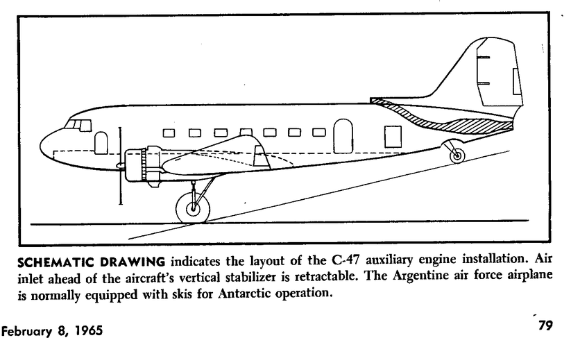

when i saw the title i thought of a DC-3 with a booster turbojet in the tail for overload takeoffs, that vaguely rings a bell. But maybe i made it up...

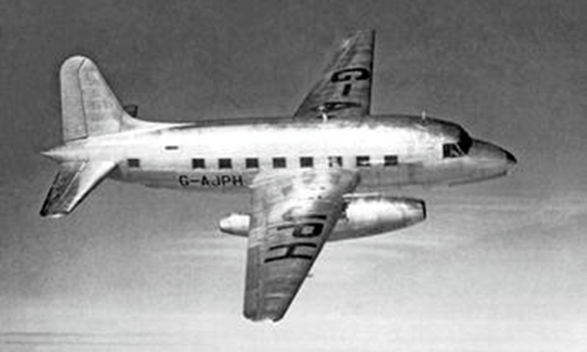

A similar configuration was the Vickers Viking that was fitted with two Nene jet engines (after removing its Bristol Hercules radial engines) as a testbed. However, I've never seen a DC-3/C-47 configured as such.

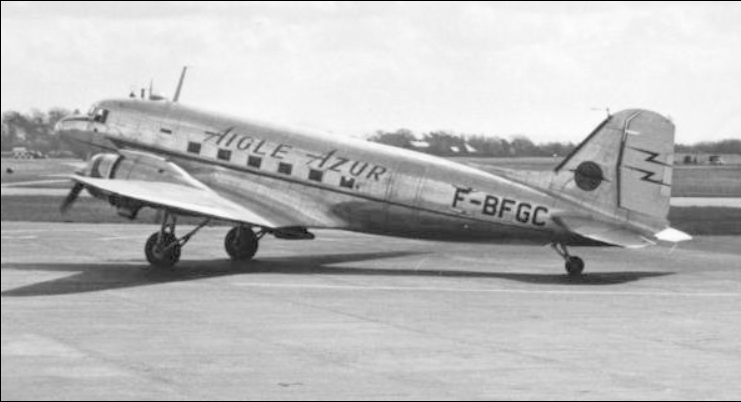

wikipedia page says
"Aigle Azur (France) Douglas C-47B in 1953, with a ventral Turbomeca Palas booster jet for hot and high operations"
This is not, however, the installation i thought i remembered. The auxiliary turbojet was mounted in the tail with an s-inlet just ahead of the vertical fin. I'm still not sure i did not make that up...
