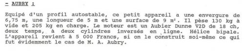

can you translate this small info about Aubry aircraft,from Trait d'Union issue 170.
"Aubry: Equipped with an automatically-stable airfoil, this little machine has a wingspan of 6,75 m, a length of 5 m and a wing surface area of 9 m2. It weighs 130 kg empty and 205 kg loaded. The engine is a 18 hp [17 bhp air-cooled] two-stroke, two-cylinder inverted inline Aubier Dunne V2D. Propeller is two-bladed. Cost for the machine is 5.000 Francs, if you build one yourself which was obviously the case for M.A. Aubry."

Great translation my dear Apophenia,and thanks for sharing Avion.
Unfortunately I believe the text is NOT related to the picture in any way. The latter is about a "Jean Aubry" while the former talks of an "A. Aubry"...
Yes Stargazer,
there is two Aurby,one is M. A. Aubry,and the other is J. Aubry,I will check about
him.
hesham said:
there is two Aurby,one is M. A. Aubry,and the other is J. Aubry,I will check about him.
Please remember that French is my native language, hesham. When I said "A. Aubry" and NOT "M. A. Aubry" it's because:

[/list]So unless a mistake was made in this text, what it talks about is a man called "A. Aubry".
