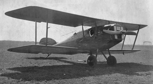

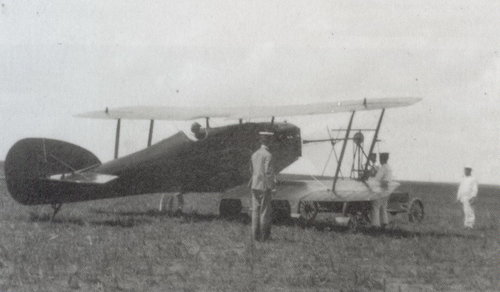

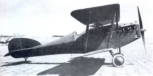

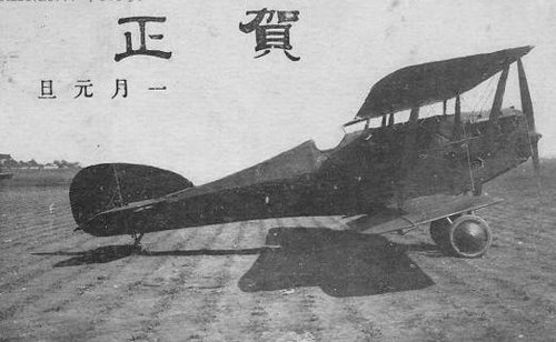

Hello friends,
I present some pictures of F.4 in jap service from my archive. Unfortunately, I do not know the origin and other details.
Fugaku1706
