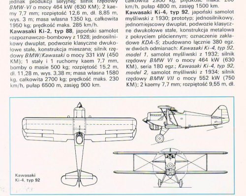

OK, but my " Encyklopedia Lotnictwa Wojskowego " t. 10 shows also :
- Kawasaki Ki-2, Type 88
> one-engined biplane, fixed gear, reco / light bomber of 1928
> 331 kW BMW / Kawasaki inline engine
> span : 15,2 m, lenght : 11,28 m, height : 3,38 m.
> empty : 1580 kg, max. : 2700 kg, max. speed : 230 km/h, ceiling : 6500 m, range : 900 km.
> two 7,7 mm mg ( pilot and gunner ) + 500 kg bombs ;
- Kawasaki Ki-4, Type 92 ( factory designation KDA-5 )
> fighter prototype of 1930, then built in two versions :
> model 1 of 1932 with 464 kW BMW / Kawasaki VI inline engine ( 180 machines series )
> model 2 of 1934 with 552 kW BMW / Kawasaki VII inline engine
> one-engined biplane, fixed gear, single-seat fighter
> span : 9,55 m, lenght : 7,05 m, height : 3,1 m.
> max. speed : 320 km/h, ceiling : 9700 m, range : 850 km.
> two 7,7 mm mg ;
- Kawasaki Ki-7, Type 91
> one-engined biplane, fixed gear, one-seat fighter of 1933
> 552 kW BMW / Kawasaki VI inline engine ( 350 machines series )
> max. speed : 320 km/h, ceiling : 9500 m, range : 850 km.
> empty : 1280 kg, max. : 1700 kg, wing area : 24 m2
> two 7,7 mm mg.
What about the rest of my hesitancies ?
I'm inciting to dip into my virusless list
full of doubts and vacancies in Ki numeration.

The Type 88, Type 91 and Type 92 designations indicate that these aircraft were accepted for service in 1928, 1931 and 1932 respectively, which tallies with all my references.
The Kitai system was not adopted until 1933, and was intended for new aircraft development specifications from this time. I have not seen these Kawasaki Kitai dsignations anywhere else, and I suspect they are not original asignments.
