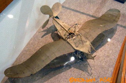

Japanese aircraft pioneer Chuhachi Ninomiya

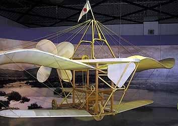

Interesting. Was the flying replica exact enough to prove the original concept could have worked with material and fabrication available?
Wishful thinking. ;D
"If he had got a 12 horsepower engine, he could have flown before the Wright brothers' success, because the difference [between his design and their flight] is 12 years," said Noguchi, now the head of an aviation consulting company.
http://www.abc.net.au/science/articles/2003/04/30/843612.htm

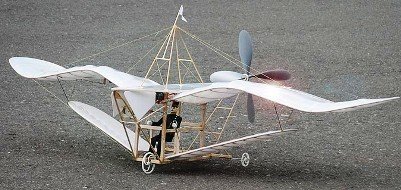

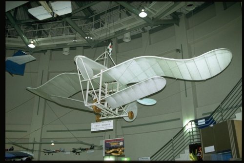

I think one of the hard problem for Tamamushi was how to get longitudinal(pitch) stability, because she had no tail horizontal stabilizer.
Tamamushi had some inherent directional(yaw) stability, because she had sweep back under wing(movable control surface).
Someone said that Tamamushi was too heavy to flight.
Propellers mounted behind the CG, ie pushers, tend to add directional stability to the aircraft if I'm remembering things right. But it looks like directional stability would still be a problem even with those huge propeller blades far aft.
Of course the comment that all it needed was a better engine is a bit funny - getting a lightweight engine but with adequate power was the biggest problem with pre-wright aircraft.

Thanks to all for your sharp opinions. ;)
RC flight model has special wing cross section and sweep back wing which contribute pitch stability.

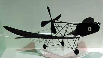

The "Karasu" is a delicate and aesthetically appealing design, in my opinion. Though it flew only in rubber-band-powered model form, it remains a beautiful piece of art.
Thanks for showing these designs to us, Blackkite-san. Regards, Harry
