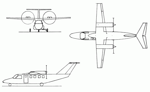

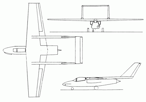

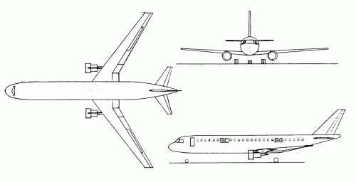

Here is the three-view arrangements of the Selene, the Ourania and the Eris:

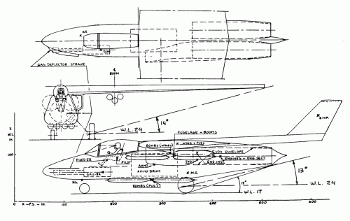

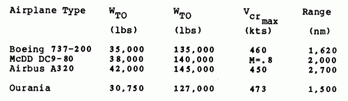

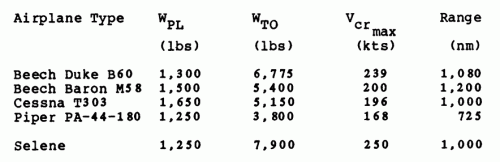

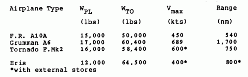

Here are the basic specifications of the Selene, Ourania and Eris as they compare to existing aircraft in their respective classes:

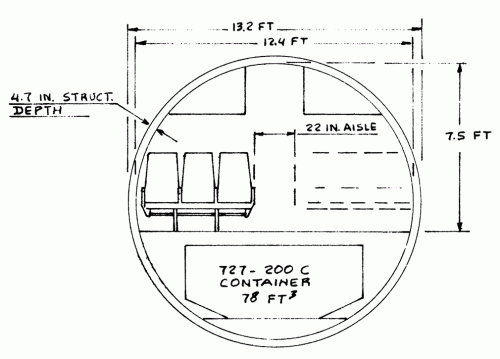

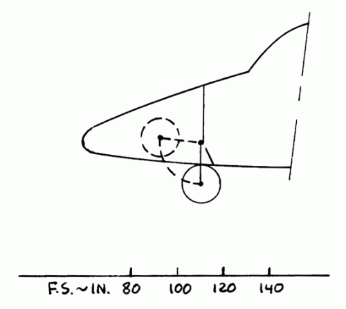

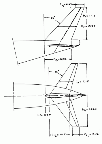

Here are detailed diagrams of the Selene:

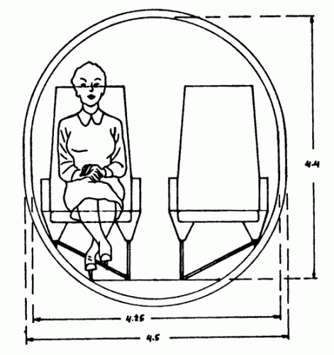

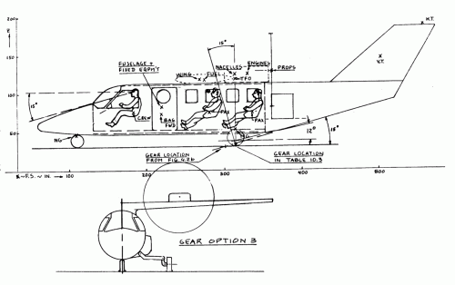

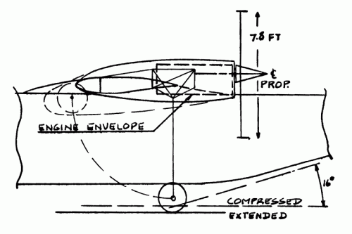

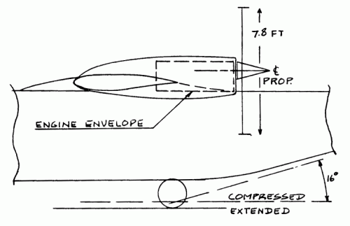

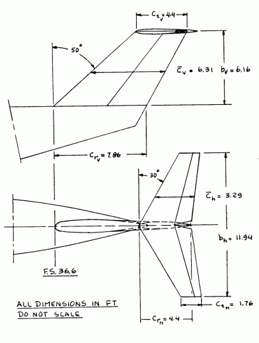

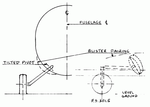

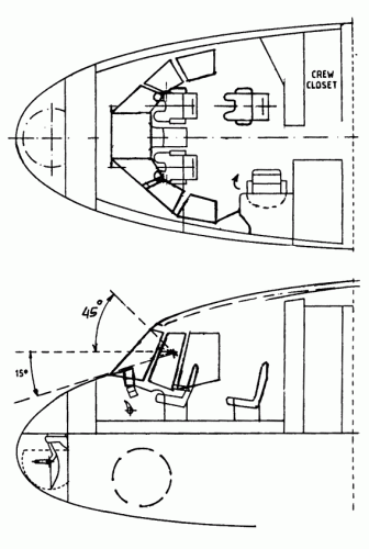

Here are detailed diagrams of the Ourania:

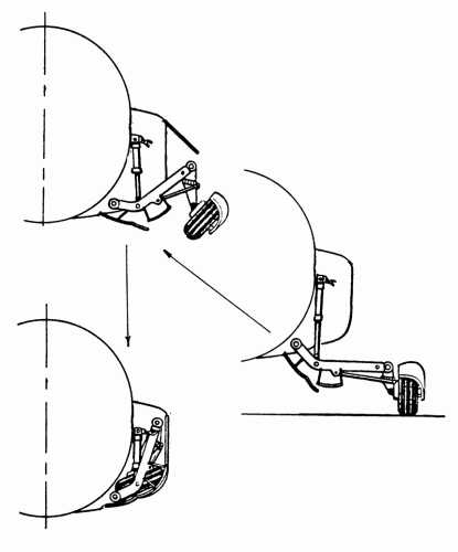

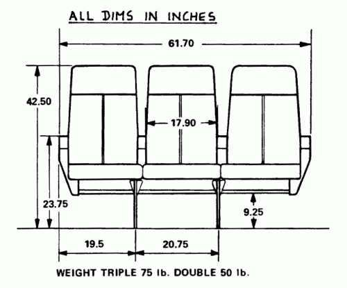

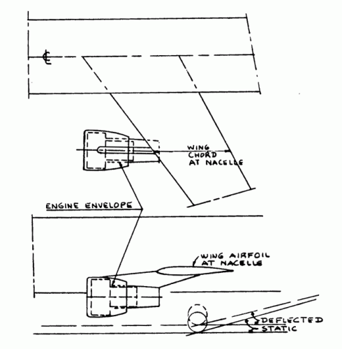

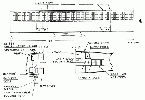

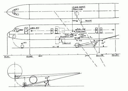

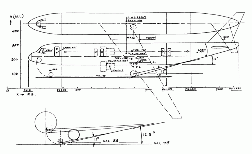

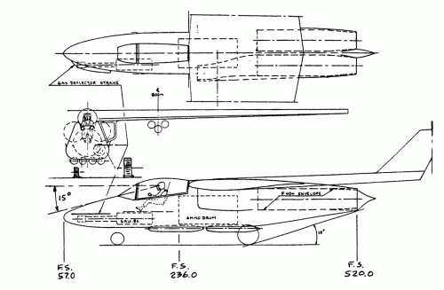

Here are detailed diagrams of the Eris:

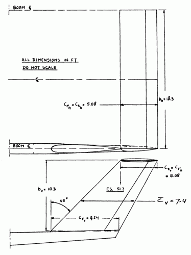

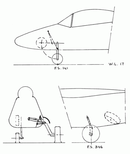

Eris is called a fighter, but I'm guessing it's really more of a strike/close air suppport/COIN-type aircraft?
I wish I could find more diagrams of aircraft which had fuel tank placement illustrated...
