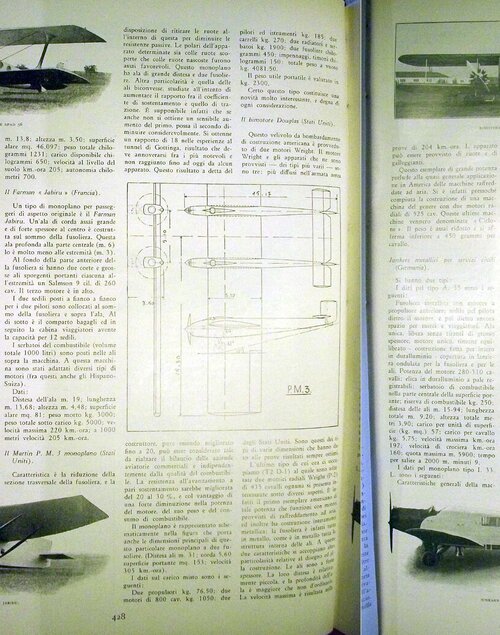

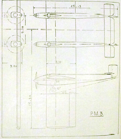

The Martin PM-3 was a project of twin fuselage two seat patrol
aircraft and powered by two engines and had estimated speed of
110 mph.
Hesham,
The 'Martin PM-3' is a mysterious design.
Despite much searching I was unable to find even a slightest bit of
info about a Martin PM-3.
What is the source of your illustration ?
My dear lark,
the source was;
http://www.flightglobal.com/FlightPDFArchive/1927/1927%20-%200290.pdf
Thanks Hesham,
I have some idea that this project is not from
the well known Martin Company.
Maybe a concept from the fertile mind of James V.Martin
I would agree with Lark. J.V.Marting was fond of twin-hulls
Lark you are correct it was James Martin formerly Grahame-White Company at Hendon.
The prior pdf had the start of the article
http://www.flightglobal.com/FlightPDFArchive/1927/1927%20-%200289.pdf
Thanks Gentlemen !
Mystery solved.
Up to the next one ;)

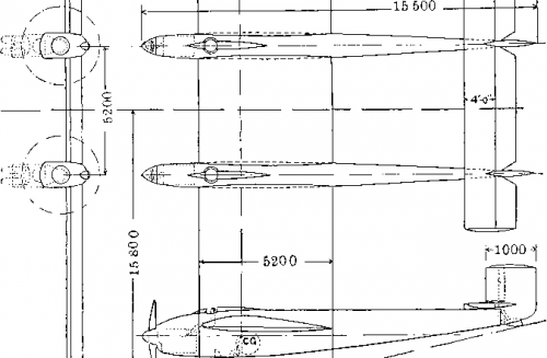

And a 3-view;
http://www.avia-it.com/act/biblioteca/periodici/PDF%20Riviste/Ala%20d'Italia/L'ALA%20D'ITALIA%201927%2006.pdf
From Le Document Aeronautique 1927.

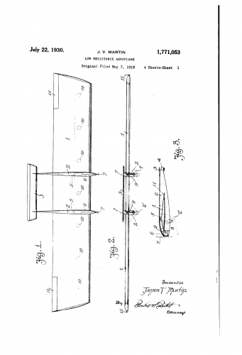

this man designed during 1908 to 1911,a glider and a tailless pusher airplanes,followed
by a cruising tractor aircraft of 1917,and K.III & K.IV single seat biplane fighters 1918,and a cruising bomber of 1919,which was a three seat bomber/recce biplane,powered by two 350 hp Sunbeam 12 later fitted by a two
400 hp Liberty 12 engine,but there is no pictures known for last two cruiser concepts,also I spoke about his patents here;
