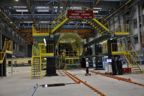

Can anybody tell me something about the "изделие 476"? Is it just the project of a stretched Il-76 or a quite different design?
(Moderators, maybe this topic has to move to the Aerospace section.)
Deino showed me the way ... The picture is from http://img3067.imagevenue.com/img.php?image=93695_Il_476_1_122_512lo.jpg#
I would like to ask our Russian forum members for a translation of the important parts of this article (source: http://www.newizv.ru/lenta/128108/):

mysterious "Izdeliye 476" is nothing more than future IL-476-based AWACS after transformation in journalist's brains
Il-476 - customer so far: DoD
first flight for first a/c (#01-01) scheduled for July 2011
'paperless manufacturing process' (many insiders are very sceptic about that - at least thay say that 'so far there will be enough paper drawings")
fuselage, empennage, landing gears - the same as on IL-76
new, 3 tons lighter, wing *construction* (not shape) based on IL-96 experience (no more inbound stringers, manufactured together with panels, but separate ones riveted to panels; less wing surface panels, number decreased in several times on 476),
IL-96 based fuel system
powerplant as on IL-76MD-90 (PS-90A-76)

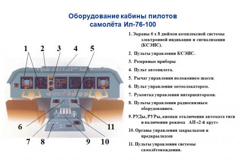

new avionics (10-15%) - picture shows as it was envisioned in 2008, but continous variations with funding make future 'glass cockpit' configuration unclear
the same crew number

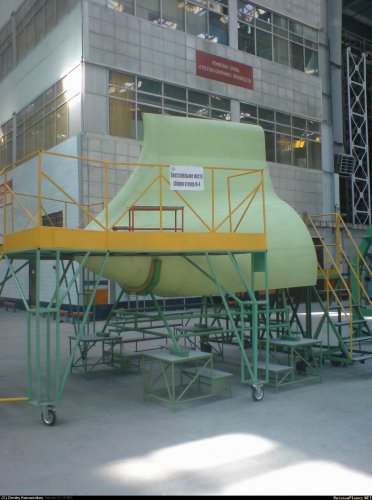

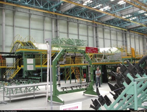

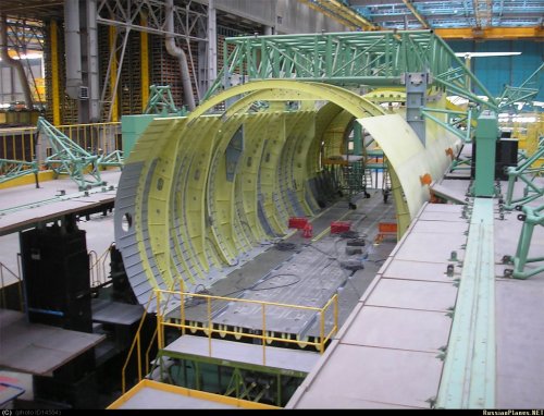

More pics.

Is this the roll-out ?
http://top81.jschina.com.cn/top81bbs/thread.php?cid=1&rootid=3664938&id=3664938
Deino
roll-out it's kinda when you roll completed and painted airplane
this case is not as bad as with first 787, but first flight of 476 is scheduled for April 2012 (was planned: July 2011)
so there will be one more roll-out I guess)
