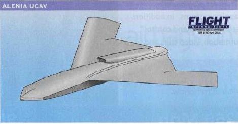

the Alenia Sky-X UCAV.
http://www.flightglobal.com/PDFArchive/View/2004/2004-09%20-%200693.html

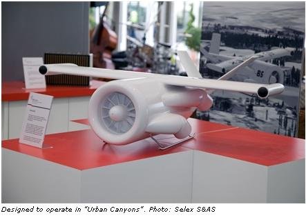

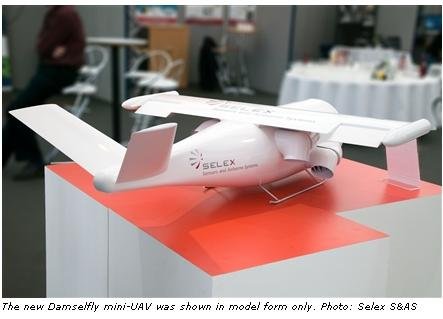

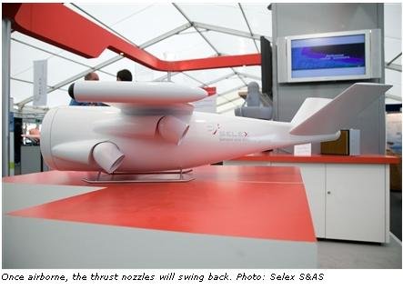

Here is a selex unveils Harrier-style UAV.
http://www.aviationweek.com/aw/blogs/defense/index.jsp?plckController=Blog&plckScript=blogScript&plckElementId=blogDest&plckBlogPage=BlogViewPost&plckPostId=Blog%3A27ec4a53-dcc8-42d0-bd3a-01329aef79a7Post%3Ac744cd37-461b-4287-af2d-2e5b32d4db84

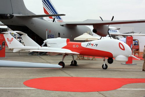

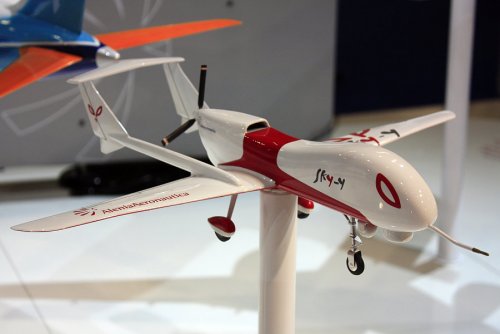

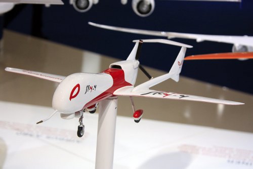

Alenia Sky-Y demonstrator
That last one is a lovely concept. Is there any more info on them beside it's in predator B class and optional internal weapon carriage?
Yes, but wait a bit. I currently finished the french UAVs/UCAVs and now I am going to the Italian ones, so I will post some further info soon.

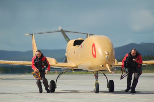

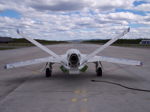

cool pic found of sky-y in testing (?) and the back end of sky-x
There are more of them in high-res @ Alenia-Aeronautica´s homepage. Use the right placed menu.

Sky-Y
From the early 2009 the bigger version of the plane called Sky-YS is in the development. The main difference is more powerful 3400 ccm engine.
Sky-X
The demonstrator started as the full-stealth flying wing called the Iron Bird. Because they wanted to cut the costs, the basic Sky-X fuselage design in the revised demonstrator is derived from a modified weapons dispenser pod (!). Does anybody know which one? This relation has caused some constraints, especially on the size because they wanted to use existing hardware as far as possible and contain costs.
Now the work continues to remove the tail and replace it with the thrust vectoring. It seems that there are some delays, but there is still a little chance, that we probably will see the modified demonstrator in October.

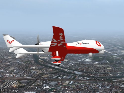

the SkyLynx MALE UAV.
http://www.defenseindustrydaily.com/neuron-ucav-spawns-isr-uav-partnership-03387/
SKY-Y
1 Dieseljet Forli derived from FIAT (or better Alfa Romeo ;D ) 1.9 JTD with 170-200 hp at 3.800 rpm. It consume about 14-15 kg (20 litres) of normal diesel oil or JP-8.
Lenght: 9,72
wingspan 9,94
net weight 850 kg
diesel oil 200 kg
payload 150 kg
ie MTOW 1.200 kg
cruise speed 140 knots (260 km/h)
ceiling 7.600 m
range: 900 km with a max flight of 14 h
possible payload: Galileo Avionica EOS-45 turret with tv-camera, IR camera & spotter
or SAR radar in X band of Selex Galileo Gabbiano family
SKY-YS
It's scheduled for the next year, about, the SKY-YS as a variant of SKY-Y with a powerfull motor and a wingspan of 16-18m (-Y 9,94m) with a MTOW of 1.600 kg (-Y 1.200kg )
This is an interesting one. Does anyone have any more pictures or any other information aside from the one already posted?
Thank you!
