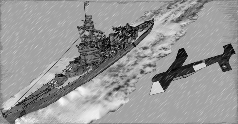

This concept is from my AH project "Savioe Cross". In short - in 1943, Mussolini was a bit quicker, and managed to broker peace with Allies before the Victor Emmanuel III. Italy managed to came out of Axis more orderly, and successfully repel (with Allied help, of course), German invasion. But as part of the dealt, Italian Navy units were send to Indian Ocean to augment Royal Navy, and make possible push for Sumatra and Singapore in 1944.
After initial operations on Indian Ocean in late 1943, it became apparent, that Italian Expeditionary Force were not well-suited for the new combat conditions. Fighting against Japanese ships and planes over ocean was quite different from fighting against British in Mediterranean. New tactical and technological approach was needed, including the new “standoff” guided weaponry.
The existing examples – radio-controlled torpedoes and full-scale assault drones – were considered too complicated to use, and ill-suited for “general” kind of operations. A new, simpler, air-launched weapon was required.
For the basic of subsequent work, Frederico Zapelloni torpedo glider (“hydrobomba”) was adapted. It was decided to fit it with some kind of remote-control, or self-homing system, which would allow it to be used from torpedo bombers against Japanese warships. A significant number of proposals were received and evaluated; in the end, three parallel programs were initiated:
* Radio-controlled bomb glider, armed with 800-kg GP bomb. Essentially, it was the simplified version of radio control system, used on “Aeronautica Lombardia”-type flying bombs. The main advantage was, that the control system was already developed and tested, and has been in service for some time. The main disadvantage was, that missile was not as “stand-off” as hoped, since the control plane needed to follow it close by, so the onboard operator could see the missile tracer.
* Auto-piloted bomb glider, with the homing acoustic torpedo as a payload. The homing version of Motobomba FF circling torpedo was suggested. This program have an advantage of simplicity; the glider only needed to carry the torpedo in general proximity of the target (which could be achieved by gyro autopilot), and the torpedo would home on it, using simple two-dimensional guidance. Problem is, that there weren’t any acoustic torpedo immediately available, and it wasn’t clear how long it would take to make one. In the end, this program was taken over by Regia Marina, since the development of acoustic torpedo was ruled to be within their responsibility.
* Autonomously-controlled, self-homing bomb with photo-contrasting seeker, armed with 800-kg GP bomb. While this was by far the most ambitious project, it was also the most promising one - and essentially it was the one, chosen for subsequent developement. Self-homing, "fire-and-forget" weapon promised significant advantages over any kind of remote-controlled one. The initial goal was to obtain the operational "Fotobomba" by late 1944, but it was deemed way too optimistic.
![1616857344514.png 1616857344514.png](https://www.secretprojects.co.uk/data/attachments/189/189356-158d8fdd3f495cb5fc86820600b6a993.jpg)

![1616857432945.png 1616857432945.png](https://www.secretprojects.co.uk/data/attachments/189/189359-f19644318ff3c8739f8cfdfed1264b03.jpg)
The payload consisted of a standard, G.P. 800-kg high-explosive bomb (the 630-kg bomb in the same casting could also be used instead), hung under the body of missile. There were two scenarios of hit possible: direct impact with immediate detonation, and missile falling short of target, with bomb detached for underwater hit.
If missile hit the water, the bomb broke away, and continued to move by inertia through the water. It was hoped, that underwater hit could be achieved. The bomb was fitted with Type A impact nose fuze (which reacted instantaneously if the bomb directly hit the target), and Type J time-delay tail fuze (which reacted with delay, if bomb hit the water). The time-delay fuze was installed to explode the bomb in water, hoping to cause underwater damage to enemy ship. The use of magnetic torpedo fuze – to explode the bomb directly beneath the enemy ship – was also suggested, but, apparently, not implemented.

![1616857364446.png 1616857364446.png](https://www.secretprojects.co.uk/data/attachments/189/189357-ae7d398869e3c3195eefe3a925cd0603.jpg)
