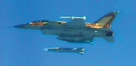

As of this moment, Israel has a Mach 5 missile that can be launched from F-16. Us doesn't really have an equivalent. Their current main supersonic missiles from tactical fighter is HARM and AARGM, both are only Mach 2
