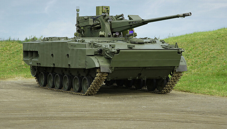

A promising weapon of Russian armored personnel carriers and infantry fighting vehicles with a trajectory-guided projectile
57-mm
It will be possible to make a guided projectile of a smaller caliber, then smaller guns will appear
57-mm. It will be possible to make a guided projectile of a smaller caliber, then smaller guns will appear
There is a Russian report somewhere that speculates one could get about 300mm of penetration from an 57×347mm using modern technologies.
The length of the "arrow" is 330 mm. estimated penetration - 183 mm
And why use penetration? Isn't it more rational to use performance?With the same parameters (only hardness - 300) under 60 - 275.8 mm in size.At right angles it will be about 236.2 mm

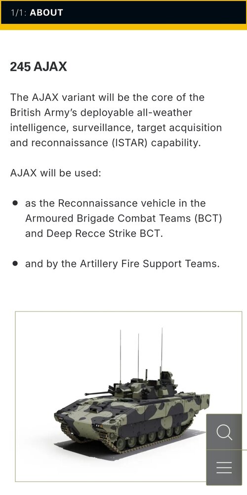

Ajax is an IFV…
What makes it a scout/recon vehicle exactly?
it’s an IFV for Cav-scouts…
The fact that its equiped with Recce Equipment, its designed as sutch (i mean the name it had before says it all with Scout SV = Specialist Vehicle. It has an special electronic suite with 6 TB of storage for sensors.
Im not saying that it doesn't have IFV features / it can't be used like that but AJAX as it is is coming as Recce where they replace CVR(T) not Warrior
Ajax is an IFV…
First there was Future Cavalry Scout Vehicle and TRACER as the linked US/UK replacements for M3 Bradley and the Scorpion family respectively, then that went away and the UK rebooted TRACER as part of the Future Rapid Effects System, within which was the Scout Specialist Vehicle, for which Ajax was the winning competitor.
TLDR: Ajax is a scout vehicle, not an IFV.
(Boxer is our future dismount carrier)
