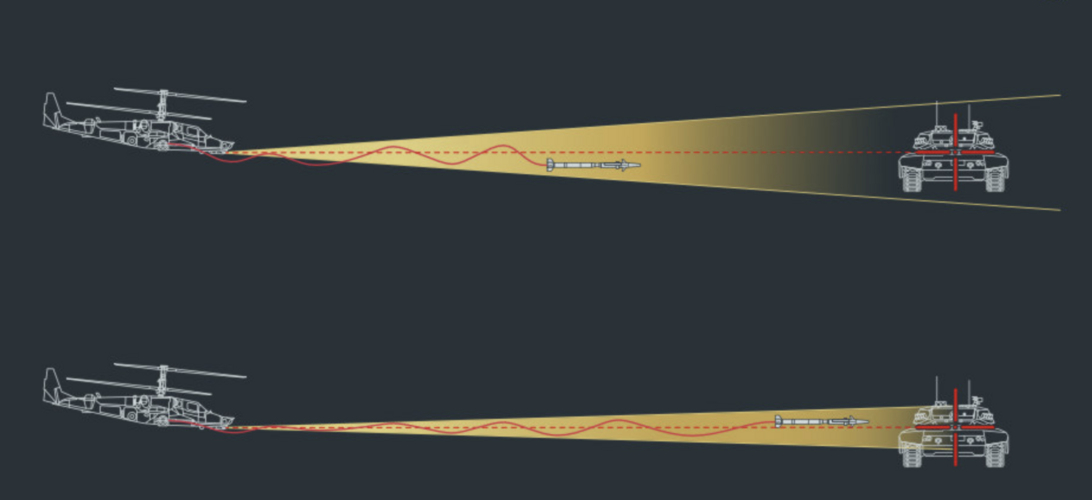

According to the theory in the game:
The reason this work is because Vikhr is a laser beam riding missile, so it will basically fly toward the direction that you point your laser grid at whether it is a tank, a helicopter, a jet fighter , a missile..etc. It does not need to rely on the small seeker on the missile to pick up target, as long as your thermal system can see the target, you can point your missile at that threat and launch
Another thing that make it work is the fact that vikhr has a proximity fuse, and SAM also have proximity fuse, so they doesn’t need to make direct contact to trigger an explosion. Furthermore, unlike common intercept of fast target where you need to predict the future location of target, in this case, the SAM will fly directly at the helicopter so vkhir only need to fly directly at that direction.
