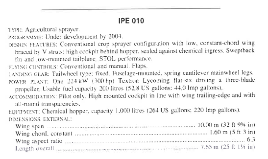

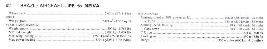

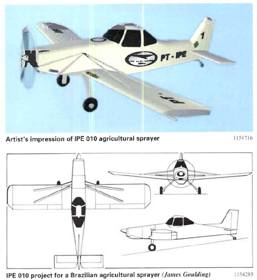

From JAWA 2007/2008,
a more info about IPE-10.
