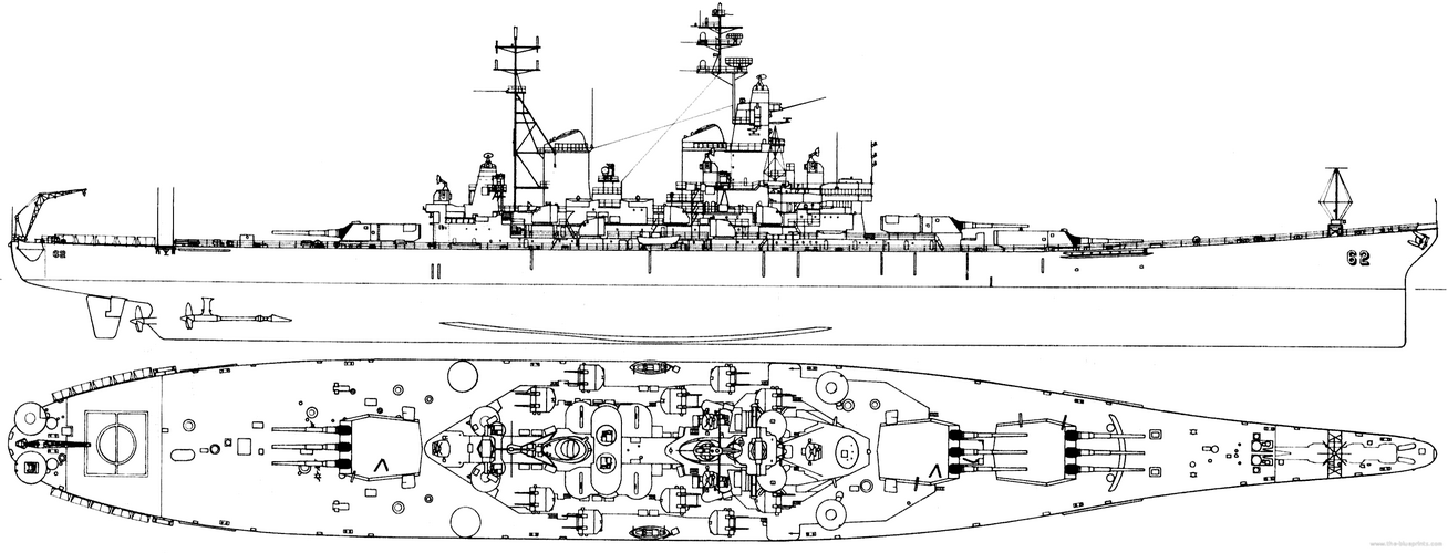

Found the drawing on the net. It shows all six Mark 56 directors and the guntubs for all 3-in/50 cal gun mount positions except the two right forward. By this time the positions right forward on the bow had been removed. It also shows the positions of the two Mark 63 directors right aft (directors themselves not then fitted).
Care of Blueprints.com:
edit, re-uploaded image after the link failed. source of image as above. Regards

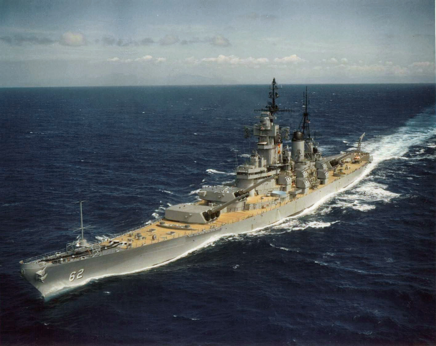

And a good shot from Wikipedia showing all three port side Mark 56, the two inactive ones covered in black canvas:
