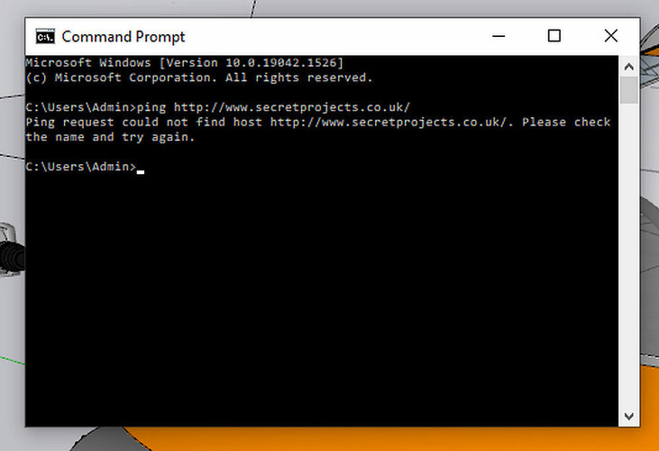

Test result.
Thanks mate. No idea myself.

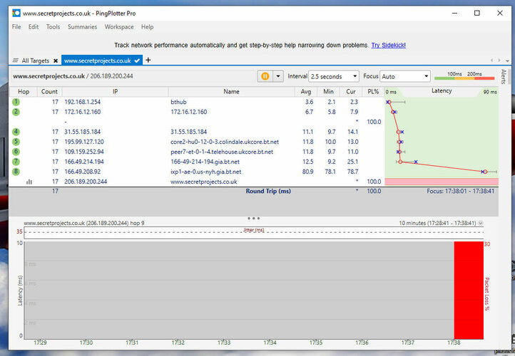

Packet loss of 30% is massive ans will result in terrible performance, pages or images failing to load. I can't help though, as the site is fine.
The last hop is red because www.secretprojects.co.uk does not allow icmp traffic. Hop #8 (ixp1-ae-0.us-nyh.gia.bt.net) right before the server is looking kinda slow. I am going to assume that is probably secretprojects hosting companies Inet connection.
No problem connecting from my rural area in the Netherlands.
I turned on icmp in the firewall to check this and its working fine from New Zealand. The server is hosted by Digital Ocean.
Server is located on the US East Coast for best performance from the two largest pools of users - USA and UK.
