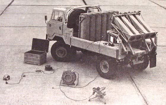

Beeswing related only to Swingfire mounted on B-class vehicles, such as the 1-tonne Land-Rover, with 6 rounds on three pairs of launchers.

Swingfire Pallet was a three or four round portable launcher that could be carried by three (or two very large) infantrymen or mounted on a Land-Rover.

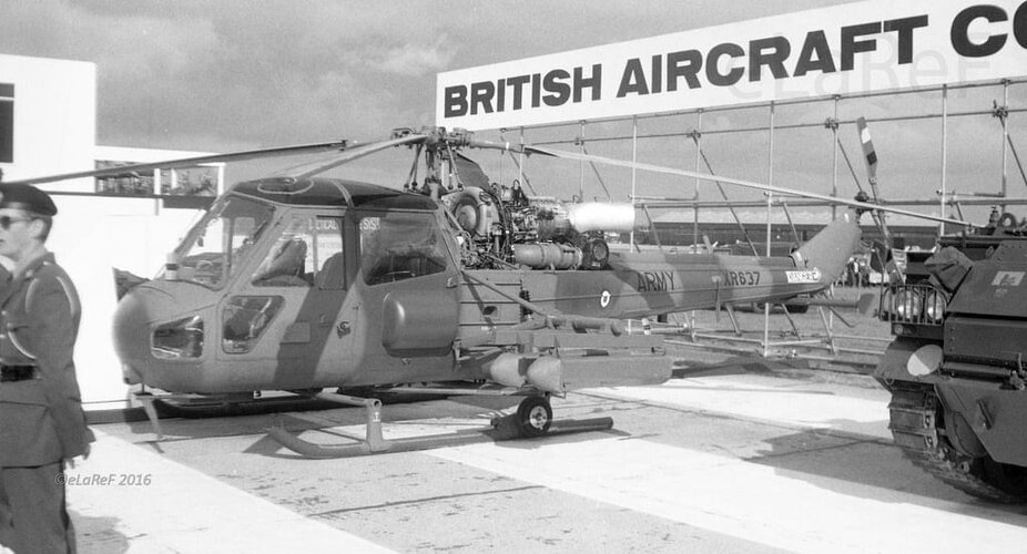

is that what’s mounted on this Scout at Farnborough Airshow in 60s
cheers
Could be Hawkswing which was tested on a Scout and was more of a dibber than a useful weapon. See the General Staff and the Helicopter for that story.
