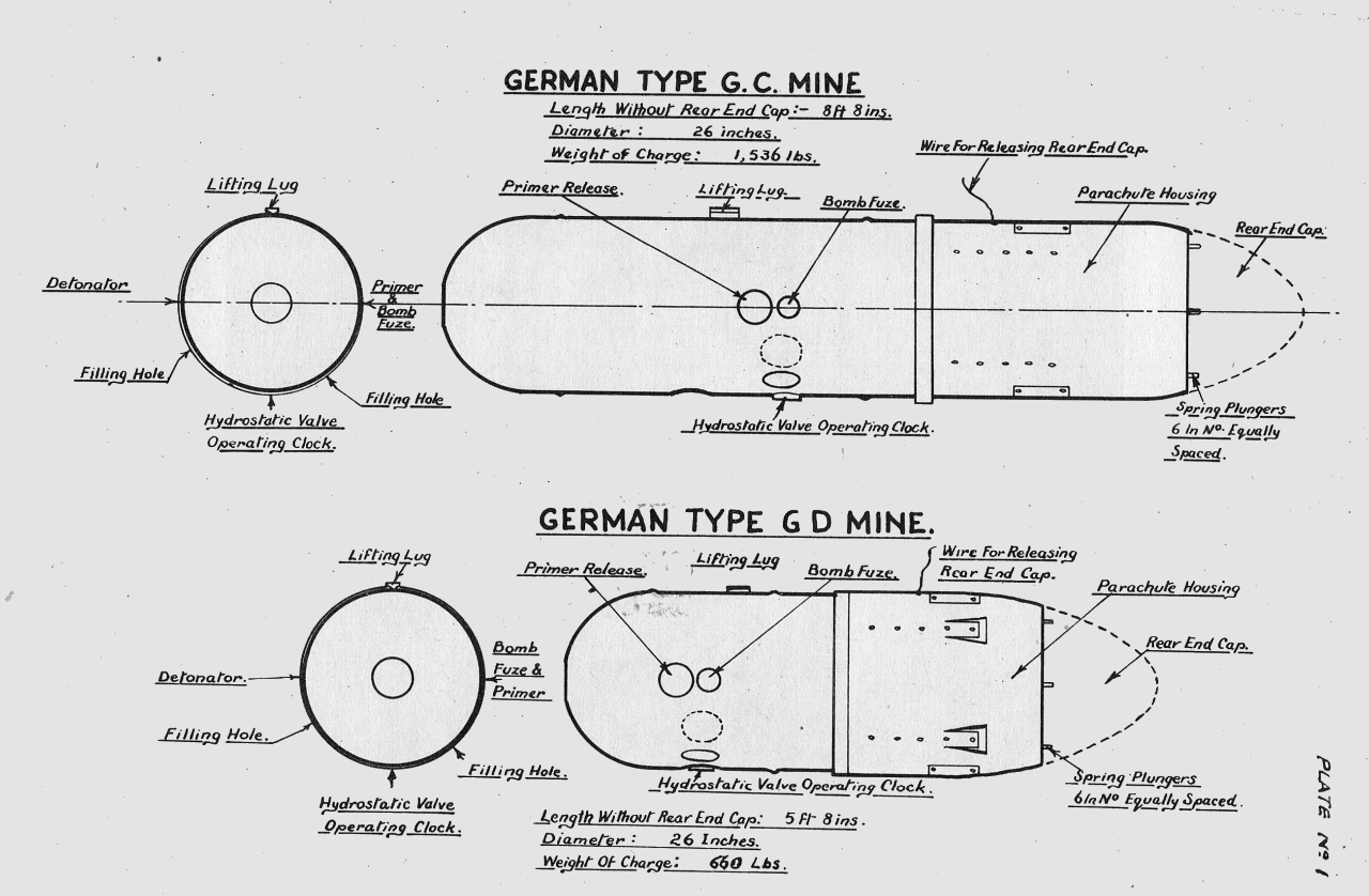

The "black rocket like thing" looks like a sea mine to be dropped by an aircraft. In the closer photo, the "nose" is to the right, and the tail is to the left and cut off the edge of the photo. Looks to me kinda like one of these with an added tail unit.
