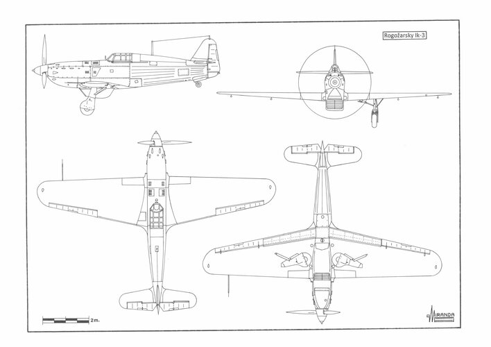

Ikarus S 49 was the first Yugoslav aircraft built after the ww2, on the legacy of it's predecessor, Rogozharski IK-3. Two out of three designers worked on the IK-3, and these aircraft shared around 75% of all parts. The main difference was the engine, soviet VK-105 PF from Yak 3.

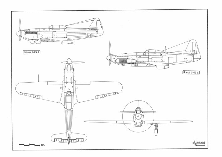

The letter A meant it was the first production series (45 planes). The second series (S 49S), had French Hispano-suiza HS 12z engine. Around 200 were built.

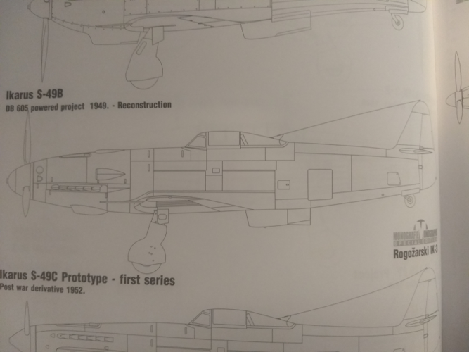

There were projects for S 49B (with Daimler Benz DB 605), S 49D (with unguided rockets) and S 49E (with tip tanks).
