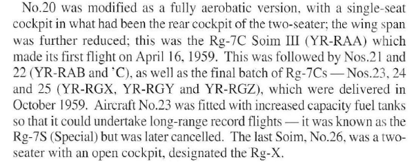

From AE 74,
I forget RG-X.

RG-X - 1959 open cockpit version of RG-7 Şoim trainer
- RG-X: Şoim c/n 26 compl'd as a 2-seater w/o canopy

[3] Note that hesham's clipping on the RG-X implies that the 'S' for Special suffix may have applied only to a cancelled long-range modification. Does anyone know for sure?[/B]
