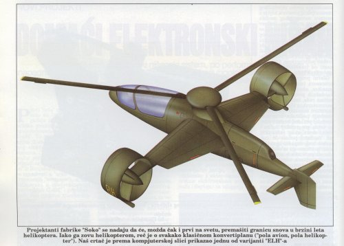

SOKO from former Yugoslavia (SFRJ) also had a high-speed rotorcraft idea!

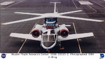

Wasn't the rotor of the Sikorsky S-72 RSRA supposed to be stopped in flight in its x-wing version?
I don't know if it ever did stop, tho...
AFAIK, it never flew with rotor, just as a conventional aircraft, but
I think, stopping a rotor in flight still is a different story, to folding
and stowing it in flight, not to mention unfold it !
Radeks,
That's an interesting project, is there anymore information about it? There are certainly quite a lot of interesting projects from the ex Warsaw Pact nations that we know nothing about.
there is not much information about this project and this picture is from Aerosvet magazine. The project was called ELH (Experimental light helicopter - Eksperimentalni laki helikopter). His speed should have been 410km/h at 4000m and because SOKO was buildnig Gazella helicopters, ELH was suposed to have a lot of parts and components from Gazella. Estimated funds needed for this project were around 14 million dolars and the first flight was suposed to be in 1994.
P.S. Yugoslavia was never a part of W.P.
Radek,
Thanks for the information. Does the magazine 'Aerosvet' feature unbuilt project aircraft from time to time?

Hesham already posted this article a couple of years ago, I'll just add some explanations, from said article.
http://www.secretprojects.co.uk/forum/index.php/topic,2943.msg84497.html#msg84497
SOKO ELH (Eksperimentalni laki helikopter - Experimental Light Helicopter) was designed in order to beat the Lynx; top speed was supposed to be 410 km/h at the altitude of 4000m. They have manufactured the Gazelle helicopter under license for almost 20 years and they intended to use as much as possible of it's technology in the new design. Main rotor was to be used only in hovering or in low speed (less than 100 km/h) modes. If proven promising, they wanted to implement this design in other types of helicopters. The construction of the first prototype was scheduled for 1993 and the first flight was expected in 1994.
