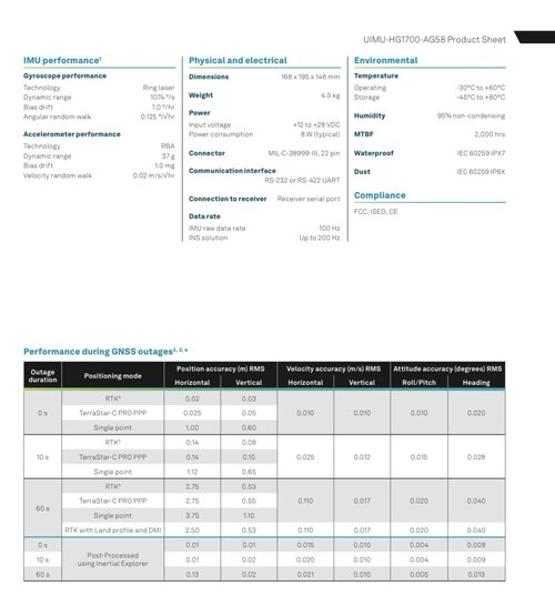

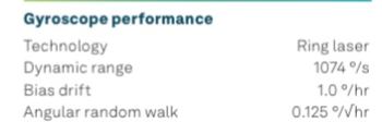

As shown by @Ronny , the drift rate of common INS system on PGM is 1 degree per hour. Does that mean after traveling for 1 hour, the missile is of course by 1 degree from original route?. For example: a JASSM traveling at Mach 0.9 will take around 30 minutes to travel 500km, and it will be off route by 0.5 degree or about 4.3 km from original destination point??
No it doesn't work that way. The "error" (in distance) for an uncorrected INS increases in time. When you initialize an INS, you tell it exactly where it it is (some military airbases had the Lat/Long numbers painted on the hangar or on the ramp; the pilot would punch in that data as part of the alignment process.) Then, the system slowly drifts and your error increases. Modern systems are corrected by external reference means. That is to say, an external position is obtained and is used to correct the INS position. Then the gyros (Mechanical, laser or MEMS) continue to drift increasing your position error again until you update again.
Your uncorrected error will look like an unbroken diagonal line in a chart where x= time and y=error. An INS corrected by Astro or GPS (or by any number of external aids) will look like a sawtooth and stay at the bottom of the chart as the system goes through the "drift, correct, drift, correct, drift, correct..." routine ad infinitum.
Clear as mud?
if INS on fighter drift, INS on weapon drift, make me think if there is datalink, will that make the drift even worse?
Well as far as the bomb (say a JDAM) is concerned, the drift rate on the [extremely low cost] strapdown INS is much higher that the aircraft system (if there are no GPS inputs to correct it). On the other hand TOF (time of flight) on the JDAM is on the order of fewer than five minutes, so there is not that much time for the error to build up.

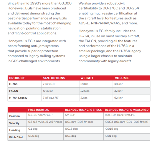

Depends on which INS, and what gyros.
A submarine's Ship's Inertial Navigation System would drift fractions of a nautical mile per day, IIRC. But that's a particularly accurate and low-drift system.
Aircraft ring-laser gyros aren't quite as accurate.

Assuming the bias drift rate of IMU in 155 mm artillery round is same as HG1700 which is 1 °/hour. The time of flight is 75 seconds to reach target 21 km away. So the angular drift would be 0.02°. For target at 21 km away, the drift is 7 meters from target position.
But for subsonic long range missiles, their time of flight is very long, so it lead to bigger miss distance
