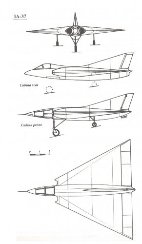

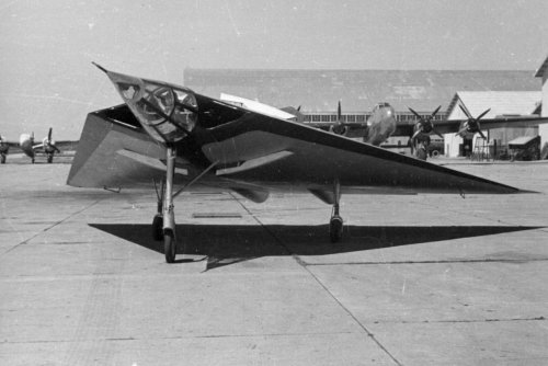

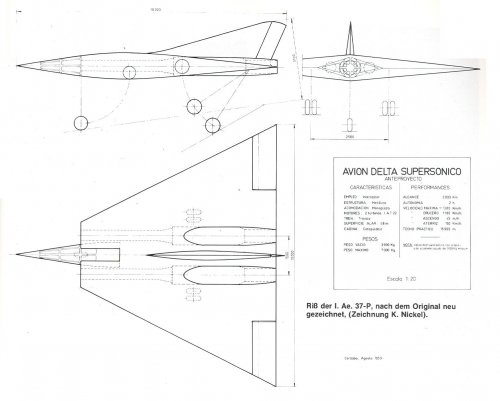

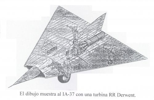

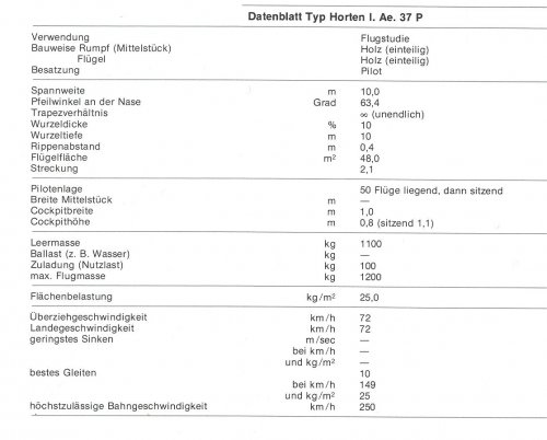

ID the delta wing aircraft ?
its one of the Horton brothers Argentinians projects idnrc the designation but it was a glider to test flight characteristics of a supersonic interceptor.
Yes, shaba is right. It is the FMA I.Ae 37-P glider in its initial, prone-pilot form. Later rebuilt with a more conventional cockpit, the glider was a development aid for the unbuilt I.Ae 37 project for a twin-engined supersonic intercerceptor.
