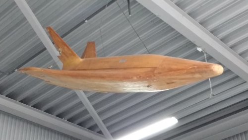

I took this spacecraft model's photo at Speyer Technik Museum but there was no information concerning the model and its history/program.
Who can help?
Thanks

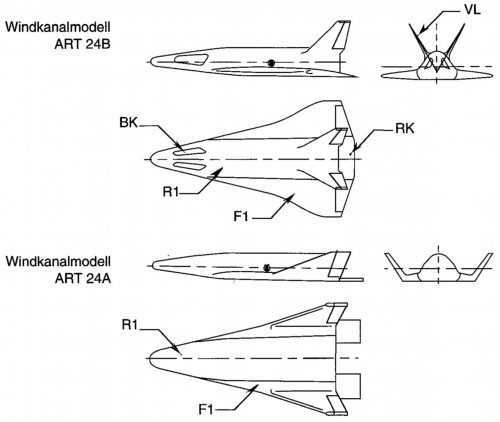

I believe it's one of the configurations considered by the German "Arbeitsgemeinschaft Rückkehrtechnologie" (ART, Reentry Technology Working Group) in the early Seventies - if memory serves, it's the 24B model (the twin fins being the main discriminator from the 24A version, if my recollection is correct).
Martin
Found a reference with illustration - both configurations are shown in figure 27 on page 331 of "Future Aeronautical and Space Systems" by Ahmed K. Noor and Samuel L. Venneri, AIAA 1997, print ISBN 978-1-56347-188-9, see the attached picture.
Martin
My best (and potentially completely erroneous) guesses for the various abbreviations of features of the wind tunnel models:
R1: Rumpf 1 (fuselage [configuation] 1)
F1: Flügel 1 (wing [configuration] 1, although that could at best refer to only the planform of the inner half of the wing without flaps and fins, and even then the dihedral doesn't match)
VL: V-Leitwerk (V empennage)
BK: Bug-Klappe (bow flap)
RK: Rumpf-Klappe (body flap)
Martin
