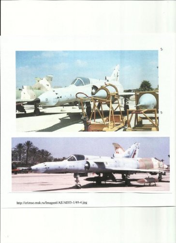

Sorry not but if anyone needs some detail images of the recce nose then this might help:
Esp. since the CAD-designer has some very good contacts to IAI and the original bird.
Another photo:

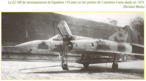

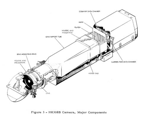

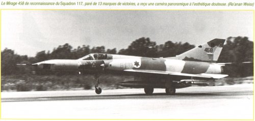

I'm speculating that the nose was designed for/equipped with the HIAC-1 LOROP long-range camera as later also fitted to the F-4E(S). can anyone confirm?
' Mirage III/5/50 en service à l'étranger' by Chenel/Liébert/Moreau, LELA Presse, has a chapter about Mirage and Kfir aircaft in Israeli service.
@Greg: the image you found shows one of two Kfir C2s that were fitted with a 1.2 metre focal length panoramic camera. Aircraft originally numbered 819 and 851, renumbered 419 and 451 after conversion. These Kfir C2s were replacements for Mirage IIICJ aircraft nrs 458, 799 (possibly others as well?) that were converted earlier.
Francillon's 'McDonnell Douglas Aircraft since 1920 - Volume II', Putnam, gives a 1.68 metre focal length for the LOROP camera when describing the F-4E(S). That seems to rule out the LOROP camera in the Kfir and Mirage noses.

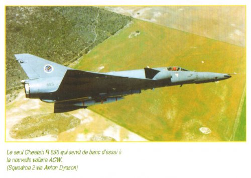

As promised. The single Cheetah R started life as Mirage IIIR2Z number 855. After conversion to Cheetah E standard, without the aerial refueling gear, its guns were removed. A remodeled nose was fitted that replaced the camera in the tip of the nose with a telemetry radar, while retaining the other cameras from the original nose. Later, a Vinten Vicon 610 pod fitted to a Cheetah's central hardpoint was preferred.
Number 855 was also used as a testbed for the Advanced Combat Wing (ACW), Chenel/Liébert/Moreau write the 855's fuselage is kept at Denel, with the ACW itself kept at Swartkops. C/L/W write there are plans to reassemble 855 at Swartkops.

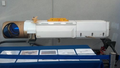

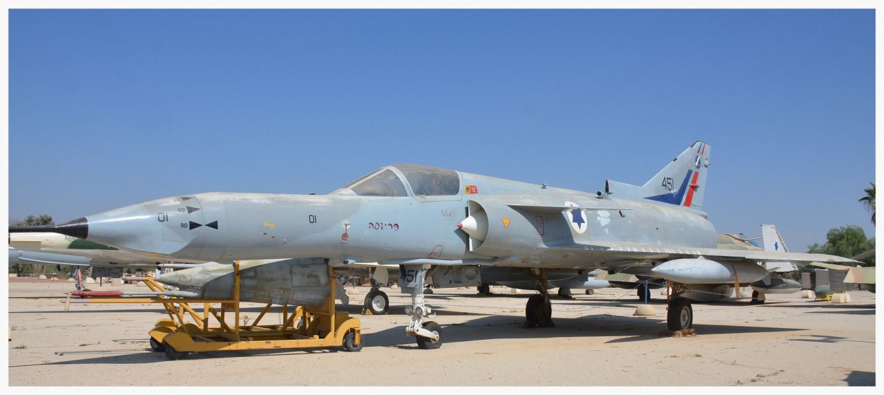

This is the IAI Kfir C-2 451 nicknamed "Prizma" with the Tzniut nose
this was the camera of the Israeli recon Kfir

Any more details (e.g. designation?)? Is it possible to get close ups of the other documents shown in that image?

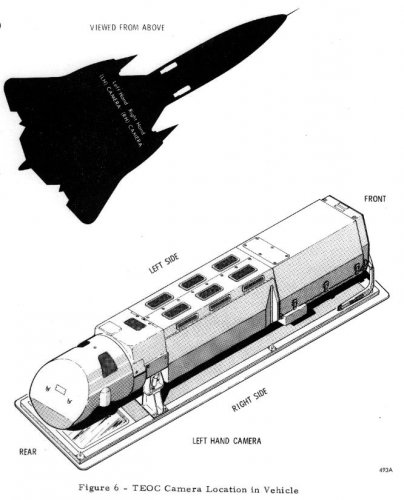

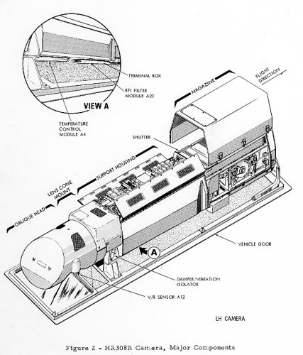

The designation of the photo-recce nose was : צניעות (latin characters tzniut) which means modesty or humility.
Interesting - so it was the same as one of the SR-71's TEOC units (some more info here - about halfway down the page)
yes indeed. the cameras (2) were supplied to Israel upon signing a ceasefire agreement wit Egypt, after the 1973 war
