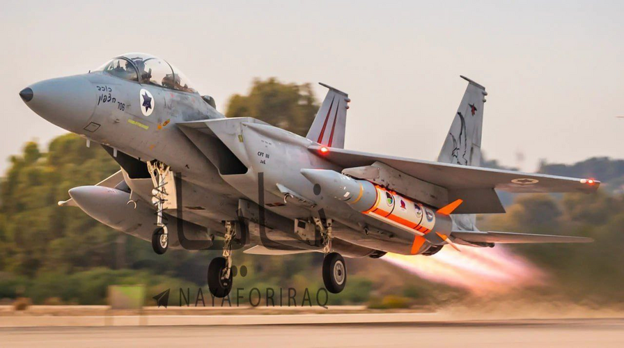

Continuing with its tradition of developing innovative products, Israel Aerospace Industries (IAI) has come up with a potent weapon.IAI officially unveiled an air-launched version of its LORA (Long Range Artillery), a short-range ballistic missile originally developed for surface launch.
The weapon, known as Air LORA, has long been rumored to exist and made its debut this week at the ILA Berlin aerospace show in the German capital.The missile is being seen as a counter to the proliferation of air defense systems.
Jacob Galifat, General Manager of the IAI/MLM Division: ”AIR LORA opens new frontiers and capabilities to our customers and improves the attack and defense capabilities for countries, with minimal risk to pilots and platforms. AIR LORA offers air forces the ability to surprise the enemy in its deep land with massive and GNSS Anti-Jam protected accurate strike capabilities”.
