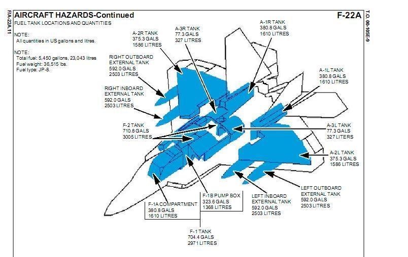

I do wonder if it would be possible to carry a bit more fuel in the F-22. There were some documents which suggested a capacity of about 20,600 lb internally but all of the newer information says about 18,000 lb. With the F-15C they managed to find room for an extra 2,000 lb or so compared to the F-15A so perhaps there was/is some unused space in the Raptor too?
F-22A fuel tank locations:

Comparing the Raptor to the Eagle I have my doubts they could replicate what they did with the Eagle. As you can see following the links, the main difference between the two was a modest increase in tankage in the wings (ignore the fuselage tanks, I had to use the F-15B instead of the F-15A). As can be seen above, there is no more room in the wings of the Raptor.
As far as a fuselage stretch, that's rather expensive. The FB-22 expanded the wing and the fuel storage therein instead.

Interestingly enough when I do the math from the numbers on that page and subtract the fuel in the external tanks I get 20,649 lb of internal fuel. Of course not all of this would be usable but that's a pretty significant difference between 18,000 lb.
Then again it looks like the they got the conversion of gallons to litres wrong so I don't know what's going on.
I suppose it makes sense that with the longer development time the F-22 had they would have figured out how to fit as much fuel as possible in the airframe. Modifying the fuselage would have been rather expensive to be sure but given all of the work that would have been needed to be done to resume production that would have been the right time if ever to make such a change for a new-build "F-22C". Was there ever a definite layout for the FB-22? I know a few different layouts were considered.
TO 105E is a odd document. The internal fuel capacities listed for the F-16, F-4 and others seem to precisely match publicly available figures. F-15C is accurate for....the F-15A; i.e. as I recall it lists less fuel internally than the F-15C is reputed to carry. One would imagine that it should list more capacity than usable fuel as most fuel systems have some room for expansion, venting, feed system and trapped fuel. One of my current hypothesis is that is the difference between the 20,650lbs and 18,000lbs. The other possibility is that the F-22 must retain fuel on board for cooling system purposes. So while the tanks carry 20,650lbs, 18,000lbs is the effective usable load.
Interestingly, AFA documents have listed the internal fuel as 18,448lbs and back when the official Raptor demo started with Max Moga, it was reported that he would request 18,500lbs added for the demo from civilian line fuelers. (FWIW). 448lbs is obviously basically insignificant but thought I'd pass that along.
