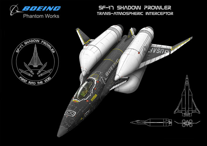

Your concept of a hypersonic stealth fighter is the stuff that dreams are made of.
