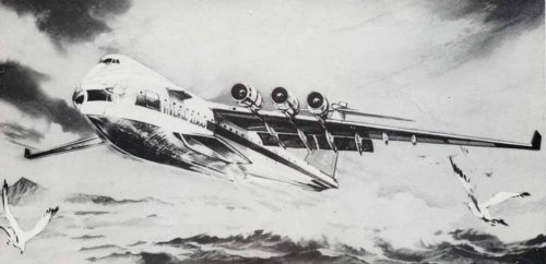

About the mentioned Hydro 2000 : I'm still not sure, if this was really a project,
or just a try to collect money...

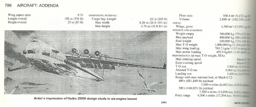

a real project mentioned in Jane's All the World's Aircraft 1995/1996.
Honestly, I'm still not convinced. Perhaps Jane's mentions the designing company and some more details ?
Is it one already credited with experience in aviation ? There were and are a lot of companies with the
main aim, not to build aircraft, but to collect investors money. And sometimes they even got attention by
Jane's All The World Aircraft .
Perhaps you can tell us, what they wrote about this project ?

OK my dear Jemiba,
and here it is.

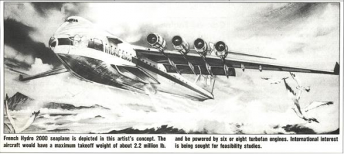

http://archive.aviationweek.com/image/spread/19900723/35/2
